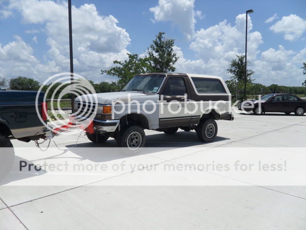

Here is the first pic of my two door, i have not seen/worked on this truck in two years. My brother is responsible for the de-storation of this truck. I can not believe how ruff its gotten. Oh well, now lets get her back to her prime so i can give my Fourdoor a well deserved break..specs:
1989 XLT
5.0 w/AOD
112K miles
4" pro comp lift
Just made her way home a few hours ago.
