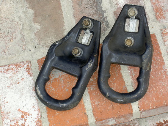

I got 1 tons
1205 Views 17 Replies 15 Participants Last post by  79BlueMule
not axles, new Super Duty tow hooks on the front :histerica :goodfinge

I don't know if I like that mounting position. Tow hooks are designed for a in-line pull and that position looks like it'll want to collapse the loop when pulled. It's probably fine as it is but I'm thinking worse case scenario.
I really couldn't see those hooks collapsing...They look good :thumbup
Wow that would have to be a HECK of a pull!!! That second top bolt on the top on the rear attachment will pretty much prevent that

I had the typical tow hooks everybody has
But I wanted to replace them before this happens :doh0715:
These Super Duty loops are 3 times the size :shocked
I too wanted a straight pull, but......
These are too wide to mount on the bottom of the frame rail for a straight pull. Might fit on front leaf spring cross member :shrug I'd have to take off the bumper to get a straight pull mount angle. I'm sure I could modify the bumper to make it work, but.......
If you look above, the old tow hooks were mounted at that same bad angle, and they held up. :toothless These are a complete loop, welded to a 3/8" plate, and use 3 1/2" bolts which should improve the structural integrity :shrug I'm sure with enough force these could be twisted off the frame, however I doubt I personally will get that aggressive.
Maybe some day I'll add some beef to the front frame horns and move them down for a straight pull. :thumbup

Did you use Grade 8 (or better) or bolts to hold them on? I can't tell by the pics.
Not the best angle to mount them. The bolts are going to see more stress due to the angle (leverage) you mounted them.
Those are grade 8. :thumbup

I have the older design superduty tow hooks.
Still haven't installed them yet.
I'd image the frame would rip off before these hooks bent.
well go do it, we'll wait.........:popc1: just messing with ya. those things look tough
