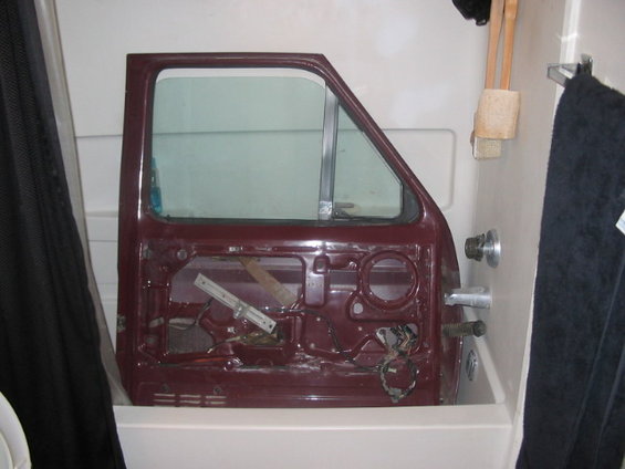

Well, it's not even close to the required 50* minimum temp outside, so I moved all operations indoors.
Katie is down in Florida, so she'll never know.
Cleaned it in the bathtub.
Had to sand it outdoors, but brought it back in for some rust bullet. The 1st coat is on the outside, I'm just letting it dry, so I can flip it over in do the inside.
I'll prolly have to leave it with just 1 coat on the outside, til it warms up outside, and I can put down some durabak.
I should be able to Herculine the inside soon. I think I'm gonna cheat, and just herculine the parts that are exposed when the interior panels are on. The whole thing will be covered in RB tho. It's kinda ghetto, but then again, so am I.:thumbup

The door is just about finished.

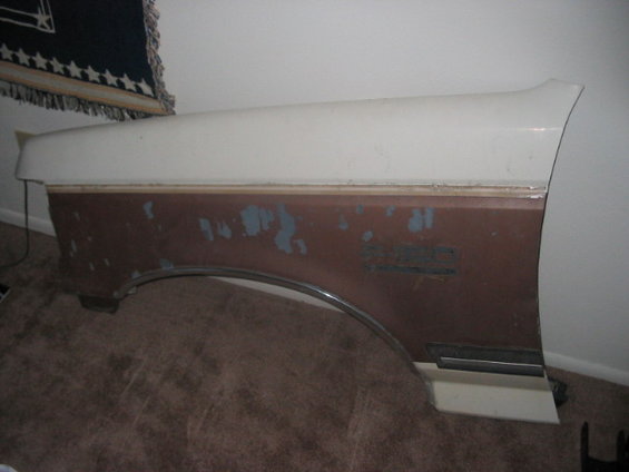

Started the front fender.
It's still drying in my living room:thumbup
This:
To this:
