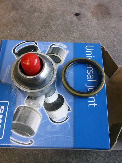

part numbers:

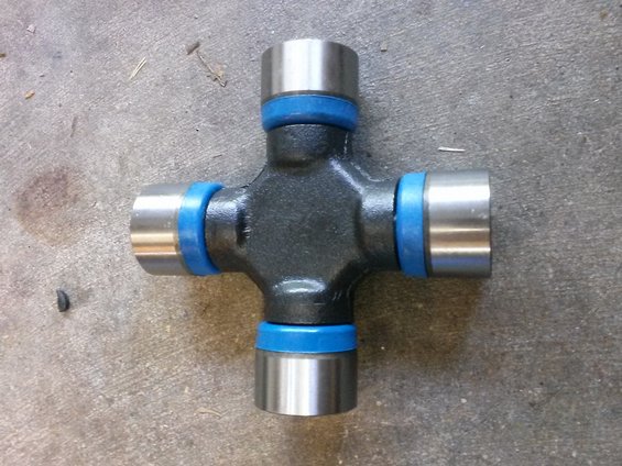

u-joints - UJ254 (brute force - high performance line, non-greaseable) - regular price $25.99

that said, on to the review...
i marked my driveshaft with a yellow paint marker so i knew how to put it back. i have a ton of pics below of the parts. the u-joints all came in a plastic bag to protect it from the elements (according to SKF's website). overall, i was pleased with the parts. look, they're chinese made u-joints. the ball kit came from our amigos south of the border. if you can handle that the vast majority of u-joints are imported, then you may consider these. if you're "USA or bust" then obviously you need to keep looking.

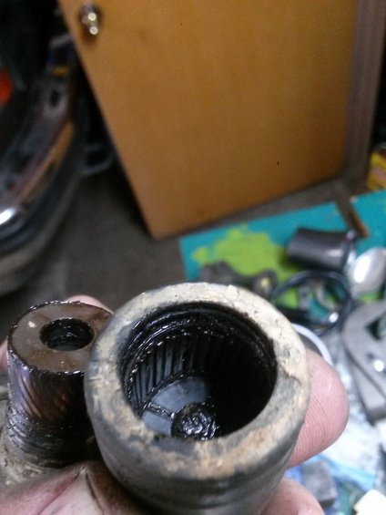

when i got to the last u-joint, i discovered i could not remove the u-joint in position #5

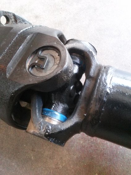

here's a pic of the installed joint

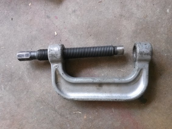

and this is the ball joint press i was using from autozone. it was bent\warped and didn't work well. that was part of why i was willing to pay to have everything re-installed. i was a little afraid that the press wouldn't work and i'd be stuck having to pay someone in the end or at least drive around to multiple parts stores until i found a press that wasn't warped.

Well... I wish you would have caught my wrong statement. I DO have the centering ball but I didn't see it in any of the exploded views in Haynes or the FSM.
I got the AAA 20% off at least, so that was cool. Also found out that my 5" bench vice isn't big enough to do this job, so I was hammering the piss out of my sockets. More tools to be replaced. Yay!
Check the noobie section. I've got to make a thread because I can't figure out how to get that damned centering ball out.
