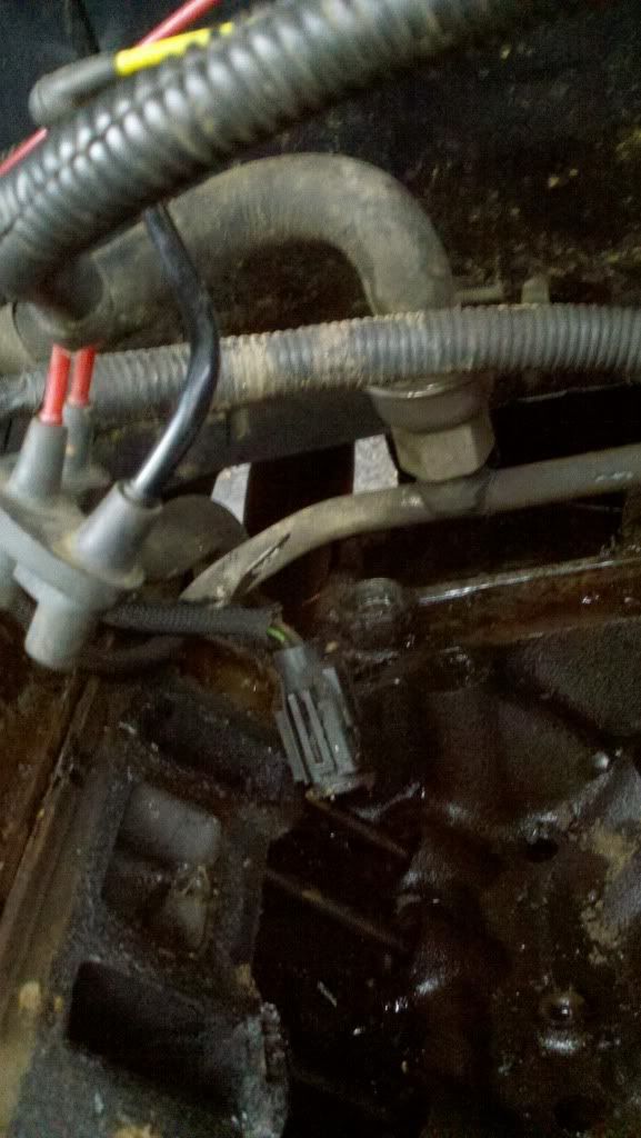

My intake manifold was leaking so it was time for a new gasket. Easy job? NOOOOOO. So first of all whats with the t40 honestly they couldnt have cast it a little differently so you dont need a special 6" long one? Anyway I got the tool pulled the intake easy no problem. Now for the lower intake should be easy. Nope. 3 bolts broke 3 bolts wtf? So time to break out the drill yup I snapped off the bit in the one bolt thats where the fml set in. So now I have no idea what to do I am at a loss anyone have any good suggestions. Drilling a drill bit out sounds borderline impossible but hey I dont do this for a living so info would be great. Also I missed one connector at the back of the engine and broke a sensor I think its the knock but if you guys could confirm that itd be great. I am not starting off so well with this bronco. :whiteflag

By the way can anyone confirm is that the knock sensor I broke? I would ha e posted earlier except I broke my laptop too. FML
