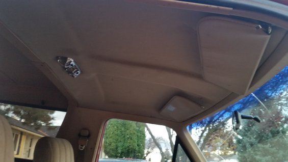

Here's my interior:
Lots and lots of screws from dismantling the entire interior to take out the headliner.
