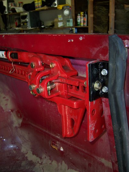

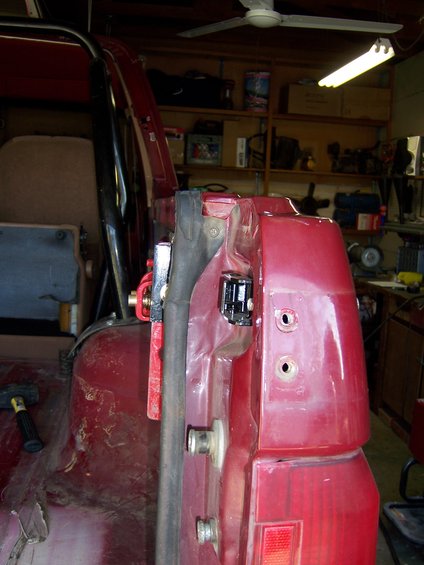

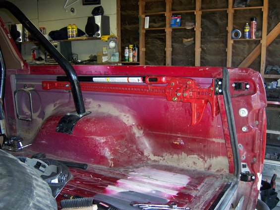

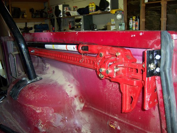

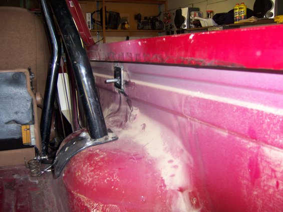

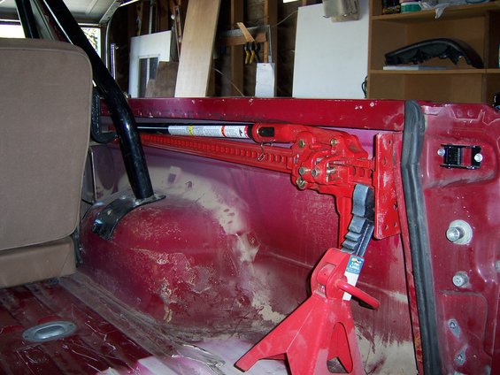

I saw someone else do this a while back and I really liked it so I did it. Check it out.

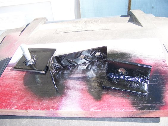

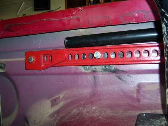

Fabbed up some brackets
Welded in one and bolted up the other
It fits nice and snug and completely out of the way
You can barely see it
Even matches the red interior :mad:

is that the 40" version? I have the 60" and have been burning my brain trying to figure out a spot to mount it up. good job, might change out the regular nut for a wing nut for easier removal.
3,869 Posts
Nice. Been thinking about this for a while. Does it make any noise over bumps?

I wrapped it with a small bungee to keep the bar from rattleing and so far, it sounds good. I have the top off, half doors and the tailagte off in exchange for a tailgate net so sounds like that arn't as noticeable at the moment.
I also have wingnuts coming so I can take it off without any tools.
Thanks
It is the 48" which is plenty for %95 rigs out there. The 60" is hard to mount and is best mounted on a cage or a bumper. My buddy has a Jeep and he bought the 60" thinking he'd never want to run out of lift and now he's buying a 48" to make it easier to bring and use.

Looks good. I like the using brackets Idea better then bolting it though the lip. Plus it tucks it away nicer.
Where does that diamond plate peice go? I think it is a support for the rear bracket but not sure.
Daystar and highlift both make handle isolaters out of urathane to keep em' from ratteling. I got one for 10 bucks at a truck show recentlly.

That's the thread I got the idea from. I don't run my bronco all that hard so I don't see pulling it out but once in a blue moon. Even then, it would come out just fine without unpacking anything. With the front wingnut off, I can pull it through the passenger door if I wanted too but It comes out nicley just normally.
