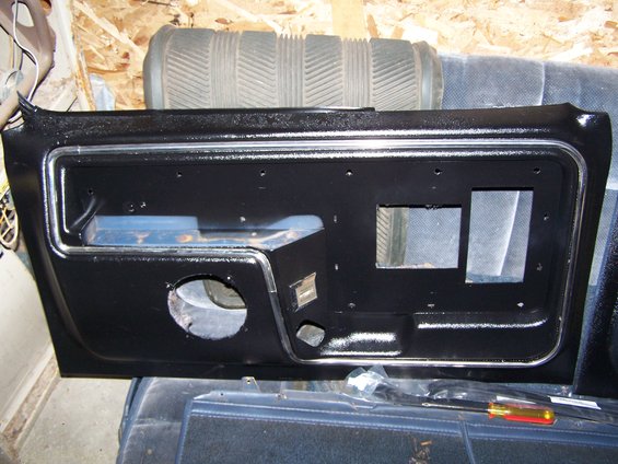

4) Your panel is now ready for paint. I went with the Krylon Fusion paint, which according to the manufacturer bonds to plastic:
I painted the foam/rubber armrest with the same stuff. After a week it was still a little tacky...it has since started to dry even more...just a precaution. If I find that I am not happy with it, I will reappolster the arm rests with the same fabric used below.
5) Once dry the chrome trim can be installed...this is the opposite of tear down. Remember to use your round and rectangle tags.
NOTE: when painting your plastic door inserts, don't forget your speaker vents and power window/lock trim.

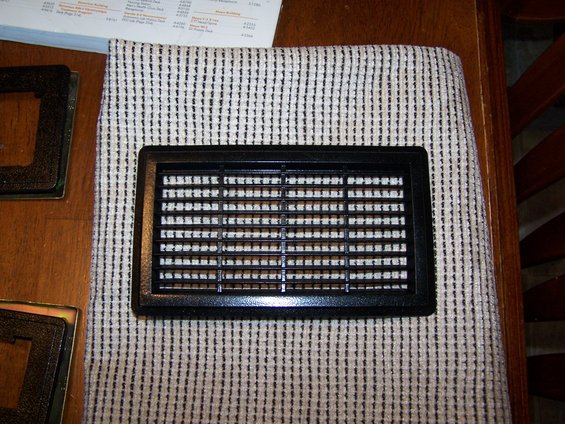

6) Next is reappolstering the fabric door insert. You will need some adhesive (Crafters Glue or Spray adhesive) and a good stapler. I went with the Stanley electric stapler/brad nailer. $30 at your local home depot

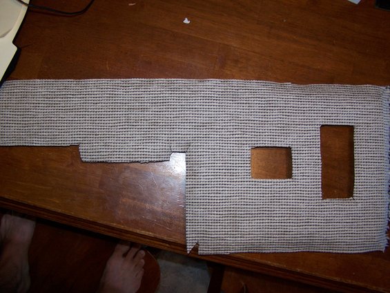

Here is the fabric I decided to go with, along with an example of how the black trim pieces will look with it:

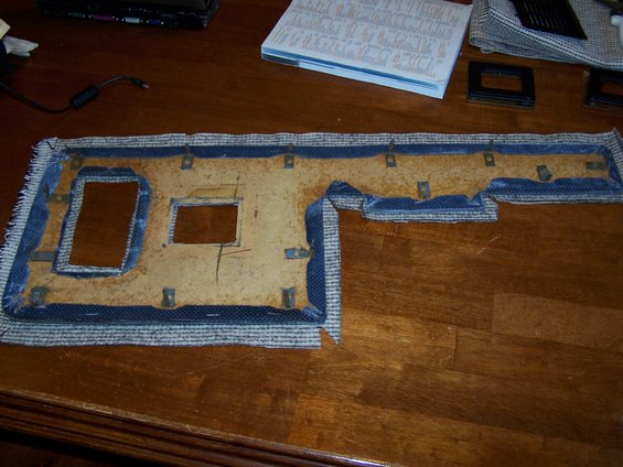

7) I decided to keep the old fabric on the old insert and layer the new fabric over the top. Simply lay the insert over your fabric and trace a line around it. This will help center it later on. Then draw another line around out to create a 3/4" to 1" border. This overlap will glue/staple to the back side of the insert:
Opposite side:
8) Simply glue the face of the old fabric and the overlap points and start folding the new fabric over the edges. Use your stapler to staple the overlap in place.

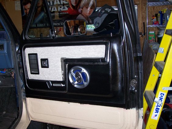

9) At this point you can install the powerlock/window trim pieces and speaker vents...this will help in holding the fabric down. Then insert the fabric insert into the plastic door insert...bend your tabs to tighten.
10) Once the arm rests have dried add them to the plastic door inserts. I then added my speakers.

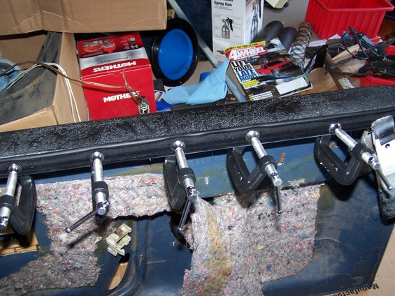

11) one other detail I worked on was adding the new weather stripping to the door insert. Simply pull the old staples out with a screw driver and needlenose, use the 3M weatherstripping adhesive and clamp the new weatherstripping down. I used small screws to pull the stripping tight to the insert instead of staples.

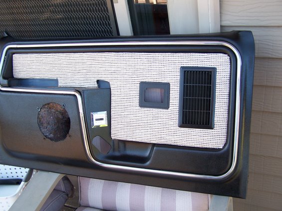

Final results:

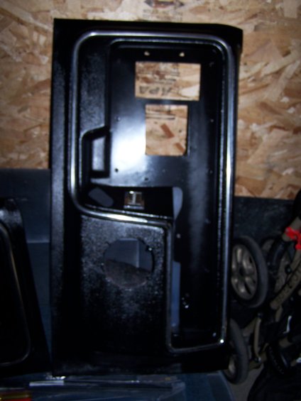

I started to paint the rear inner panels and plan to reappolster the arm rests. I need to get some more paint as I ran out and still have more to do. This time, I cleaned the panels with soap, water and then Xylene to strip any wax, dirt, etc.

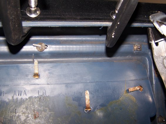

Before you paint make sure to take off the arm rests. You will see two pinch clips for each arm rest. They look like pieces of wire hanger. Push the tabs in (squeeze them) and pull on the arm rest as you slide them out of the round retainers:
Here are some pics of them painted, I have one more coat to apply:
