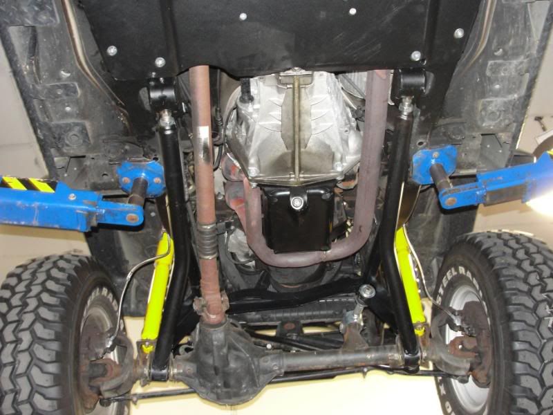

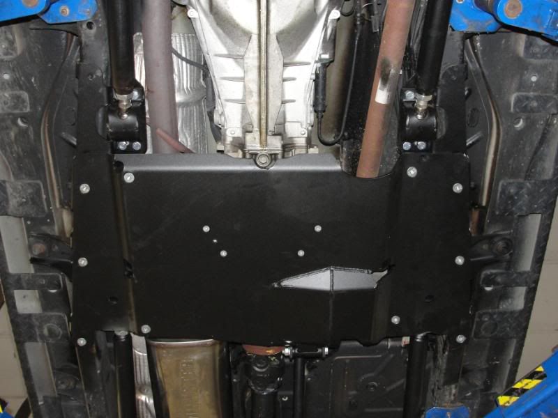

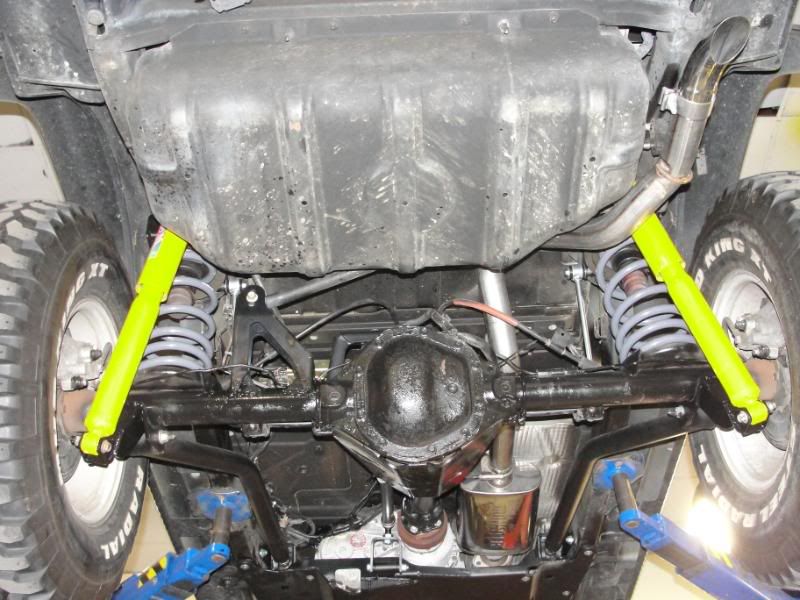

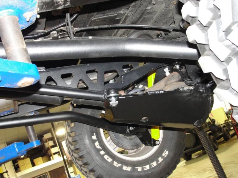

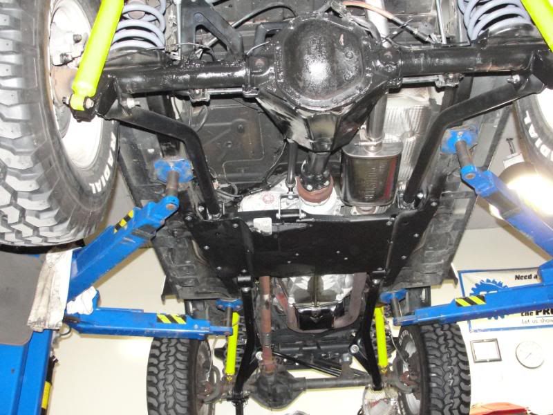

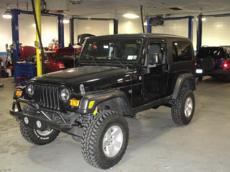

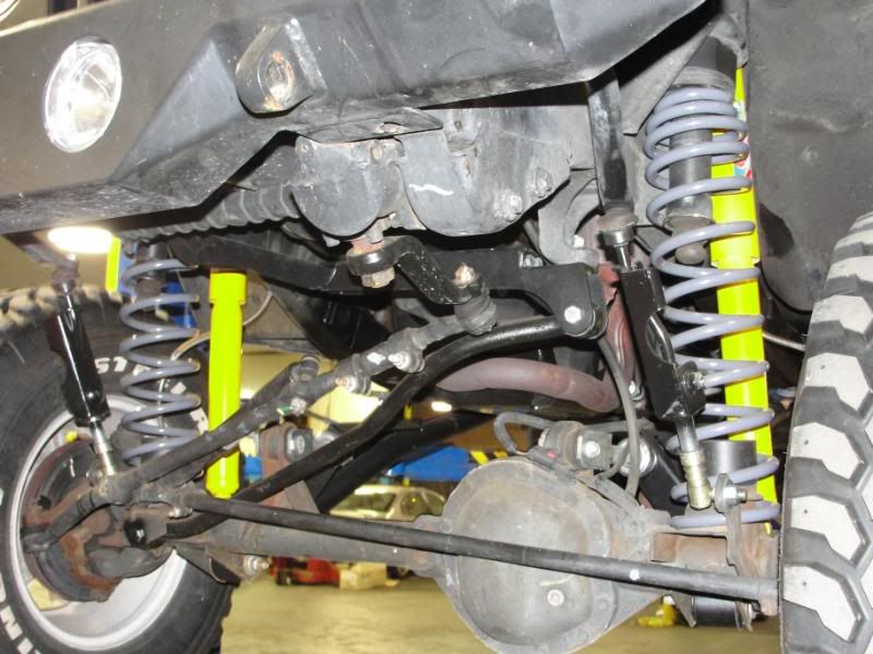

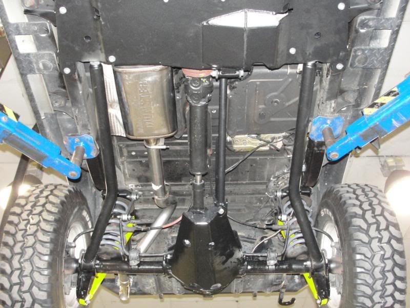

So my bosses son has a '06 wrangler rubicon and someone took him wheeling and he got hooked and wanted to lift it. So he orders a AEV NTH degree 4.5" long arm kit for it and i started reading the instuctions and got scared. It has to be one of the most over engineered things i have ever seen, it has like 50+ pages of instuction and is writing by an engineer so some of it was kind of hard to understand.
I spent about 2 months and about 45 hours working on it here and there and it turned out very well and it drives better that any lifted wrangler i have been it. So have a look. (still need to get some flex pics)

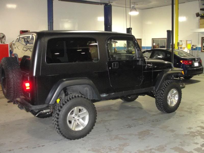

So here's an update to this if anyone cares. He put a AEV highline fender kit on it and some 37's on AEV wheels. This thing looks bad ass now and i went for a drive in it and its the best riding lifted Jeep i have ever driven, I like it so much i almost want one of my own. On to the pics
Highline fenders and 33's
37's installed
Me parked next to it, my truck kind of feels small.
A little flexing.
Designated Tranny Killer

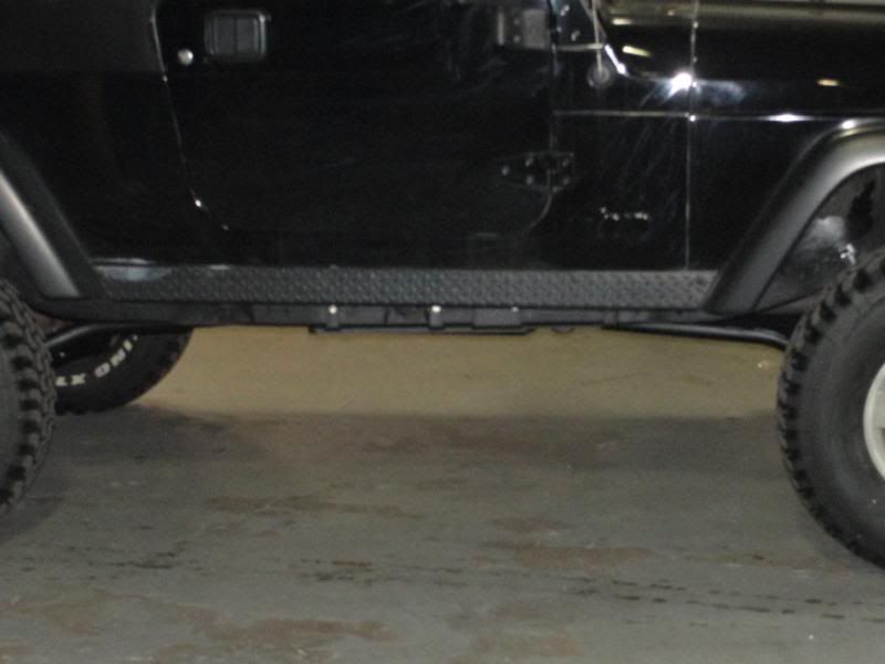

6,958 Posts
He needs to get some sliders on there. Looks BA though
2,145 Posts
I must say that jeep looks really good!
