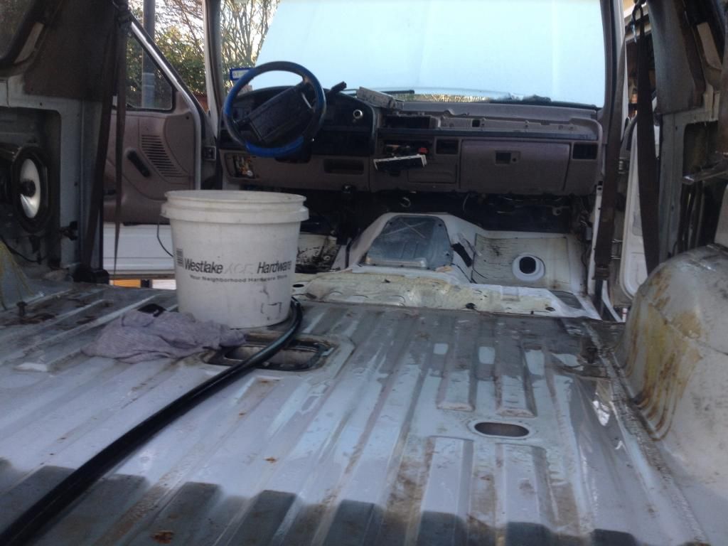

I removed the rubber floor and all the interior. Next up was the pressure washer, and some scrubbing.

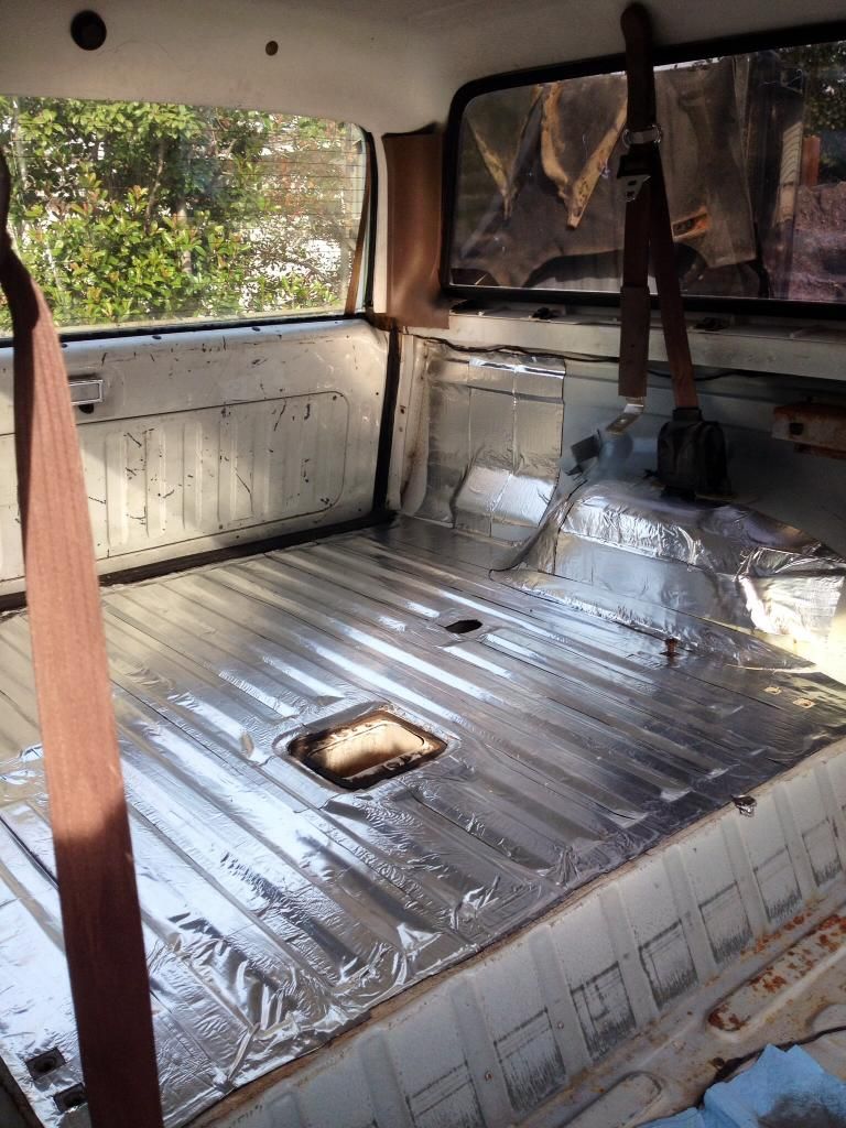

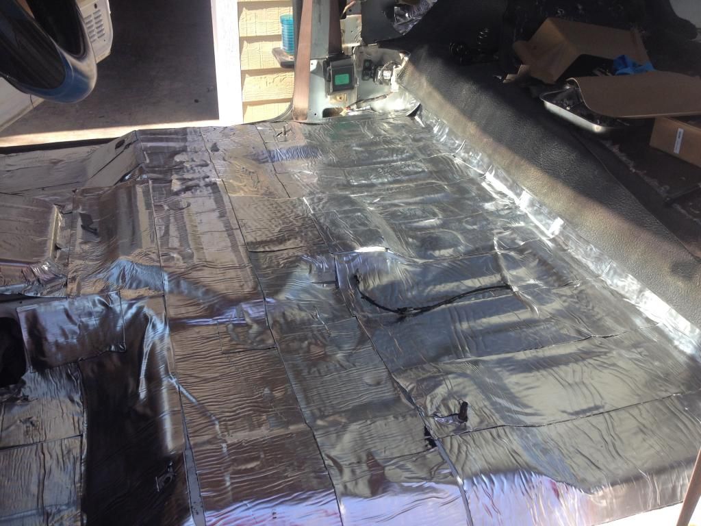

Next I installed some sound deadner.

Same stuff I always use, Quick Roof, peel n seal. Works pretty good.
Use the Force...
968 Posts
Ya, that's what it looked like. I've been using it, too. I have the doors done, going to do the floors here soon. Made a huge difference in the doors. No rattle when they shut, very solid and the speakers sound better.
