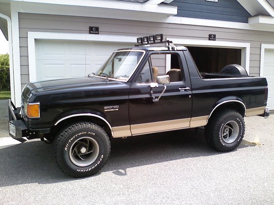

How she kind of looks right now:

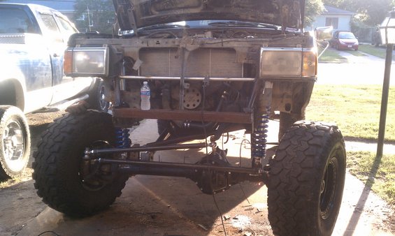

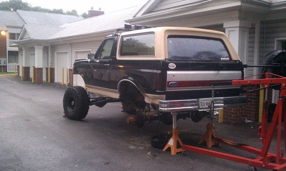

So here are a few current shots of how the bronco looks:
Progress for yesterday was yanking out the Sterling 10.25 and pulling it apart in preparation for gears and locker to be installed.
