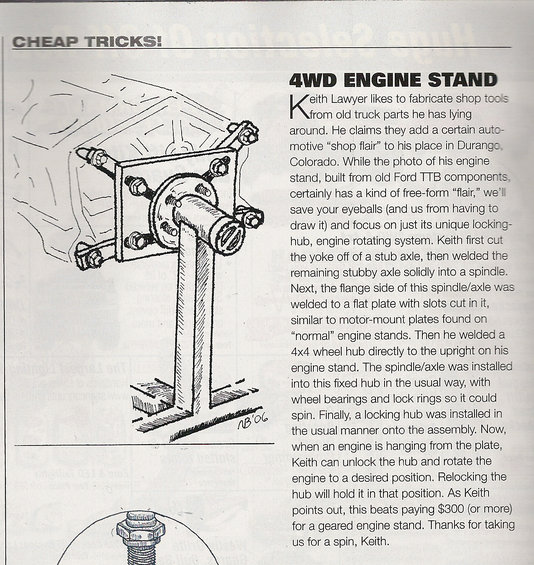

well, at least his engine stand is.
(click for fullsize pic)
and then he gets a mention in another person's tech tip. i dont think they realize how easily we break ttb parts for us to readily have junk on hand.
