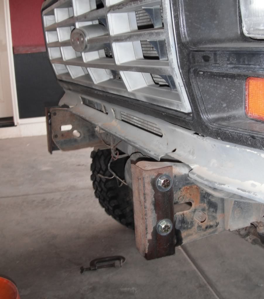

First off, Bolting on some angle iron to build off of:

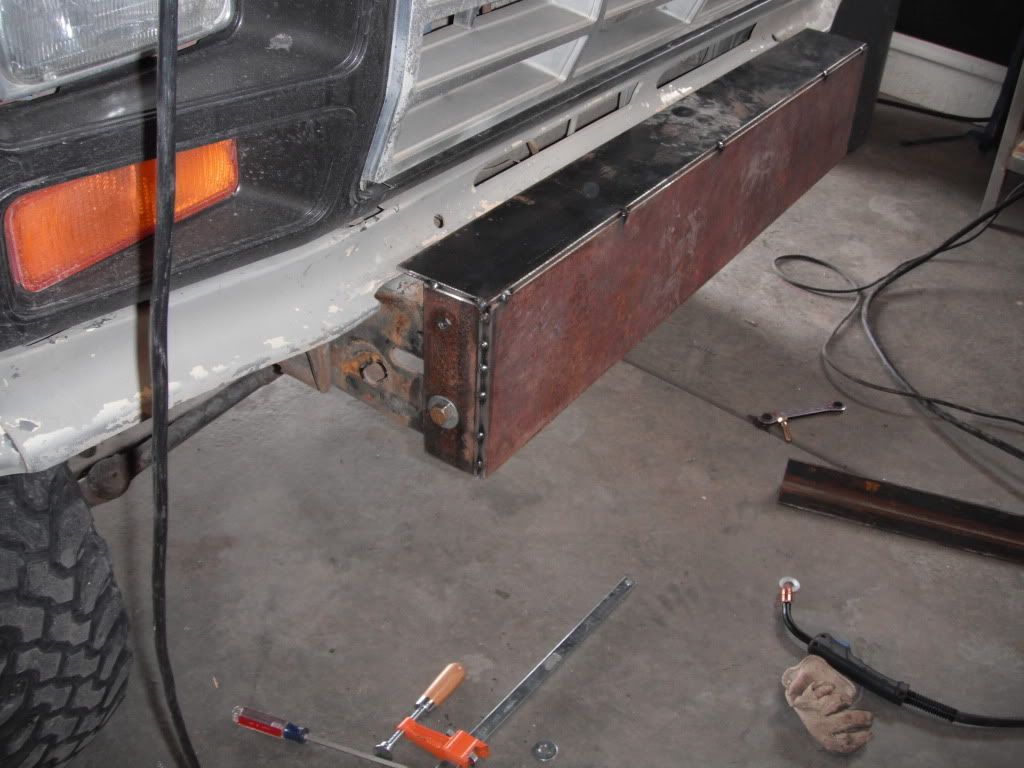

And tacking on the front plate:

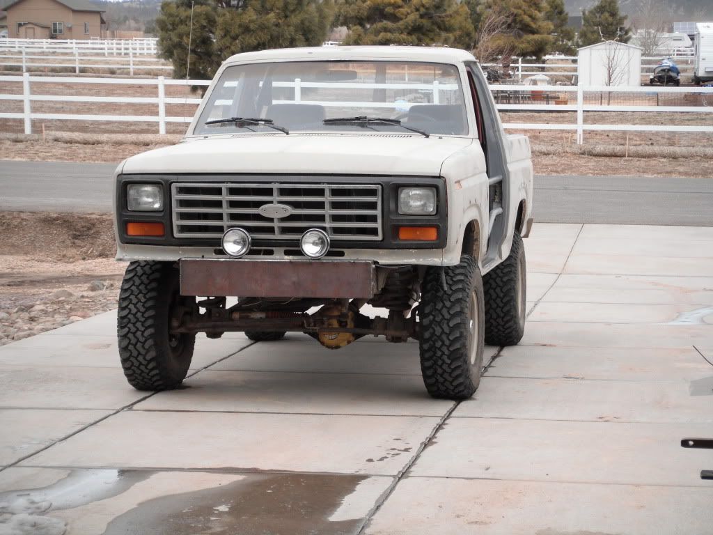

So far on the truck:
