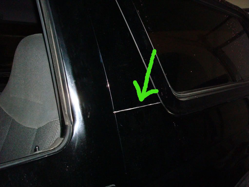

As I mentioned in another post, my '92 leaks like crazy whenever it rains. I've had water stream in from here:
I was sure it was the forward seal on the top, so I replaced it. Still leaked. Peeled off new seal and reglued it. Still leaked. Peeled and reglued again. Leaked. I finally got it thru my thick skull that it's not the seal. The channel between the seal on the top and seal on the cab was dry right after I did a leak test (running the hose on the cab).

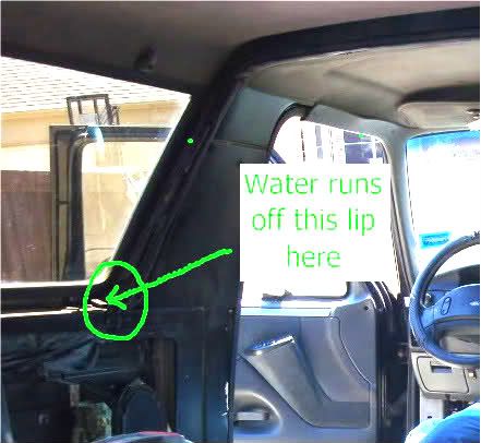

I ran the hose on this seam, near where top meets the cab:
and water poured out from that same lip on the backside of the b-pillar interior. I've read lots about the fix for the cracks in the roof at the rain gutter, but nothing about fixing this seam. Any idea how to fix that? Sealant? Welding? Chewing gum?

Automotive Seam Sealer Black Ultra Flex - Caulk Tube
Price: $11.51
In Stock.
Ships from and sold by TCP Global Corp.
Apply to painted or raw steel panels with a standard caulking gun.
Duplicate sealed factory seams on hoods, firewalls, trunks, and floor boards.
Sealer sets up in less than 2 minutes and can be painted in 45 minutes.
If required, it can be sanded for a smoother finish.
Fits regular caulking guns. Remove end cap prior to insertion into your caulk gun.

The seams on mine have been painted over. What's the best way to clear it out for a fresh start?
I'm terrible with a caulk gun. I usually tape the area, run a pretty wiggly bead and then smooth it with a wet finger. Will that work with Seam Sealer?

yes, but you do not need to get your finger wet....
PD
tape horizontally above & below seam to protect paint
Use single edge razor blade to scribe a line horiz area betwen tapes
Scrape out the old stuff carefully;

LOL no it doesnt have to be the gold dial. Good thought though. Yes it is liquid soap. You can use shampoo or any other clearish soap or KY if you're nasty hehe. That is just what my dad taught me when installing kitchen and bathroom sinks/tubs and smothing the caulking out to a glass finish. You can use any kind JUST DONT ACCIDENTALLY MIX THE SOAP AND SEALER TOGETHER WITH YOUR FINGER. If you do you will have tiny air pockets from the soap getting under the sealer and it will leak. Use minimal soap, but make sure its completely around your finger tip. Once you start to smooth it out, do not stop, make one long pass and that should do it! Good luck.

Woah.. I thought that was a welded peice?
black-on-black 4x4 Nope, get out to the truck and take along a magnet lol. It will NOT stick
yo, Since ToddMcF2002 mentioned this threads in another post; I'll add;
That Extension Panel; also ref. to as a "sail panel" (esp in the old Contour forums for that car) is metal; a prev. owner or shop may have used alum or even plastic panels to replace a damaged piece.
Info, Image and Sources; "... Ford describes it in Roof Cracks Repair Procedure TSB 96-20-11 by Ford for 80-96; altho Ford doesn't list a PN for it; it is just described as "Reinforcement – Body Side Inner Panel LH & RH (Sail) in my site. But Ford also describes it as an "Extension Panel" as shown in this diagram & listing by miesk5 at FSB

So give em a call to see if it's still available; otherwise it's yard cut-off task.

SO this panel is actually Seam Sealed into place and glued, not welded? Amazing. I had no idea.
