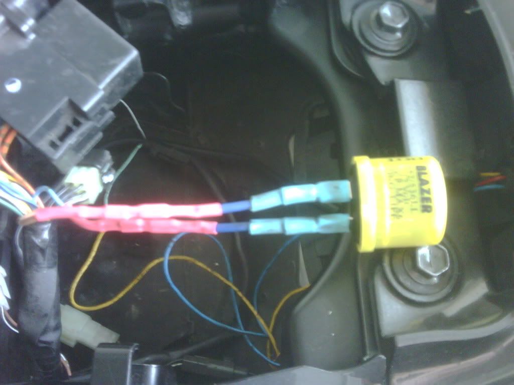

I used a blazer electronic flasher I bought at vatozone on my bike and it fixed the flash rate after getting led blinkers. The electronic flasher usually fix the resistance problem you get from having led bulbs.
