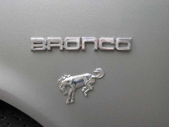

Removed the XLT badge and added the Bucking Bronco.
Cool one, I kinda like that one, where/what's it from?
I also kinda like the retro V8 symbol I've seen lately, I
'member it from when I was a kid.
I picked those up for about $3 each at a swap shop. You can order new ones from one of the big Bronco places but they are not cheap.
The Bronco script is the original for an 88 it just looks funny from the chrome reflecting. I also thought about hand painting the sides of each letter black but decided it was to much trouble.
