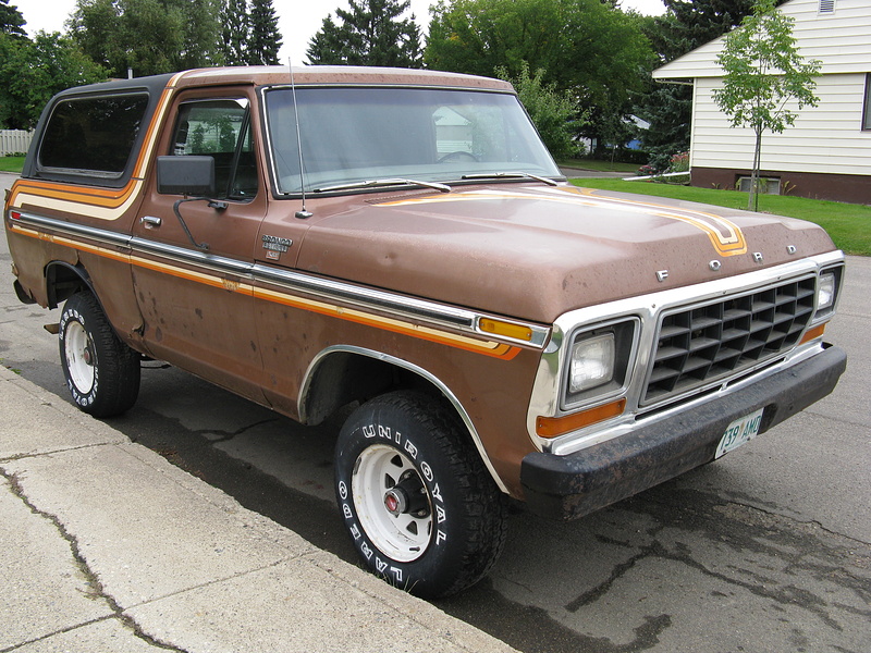

so i have a 78 bronco and its condition and fuel efficiency has made me really consider getting a newer more efficient vehicle, but i just love the bronco to the point were i now want to make it more fuel efficient and get it back to normal working conditions so i can keep using it for as long as possible.
im a bang for my buck kinda guy and im looking for all the cheap and simple things that can be done to increase the life/efficiency of my vehicle, and i do not want to have someone else do the work for me, so if there are instructions on the internet, ill do it myself.
examples would be: replacing spark plugs, filters, oils/liquids/distributor related things, ignition systems, anything in the area of "bolt on".
i have around $1000 to put towards the work id like to do on my bronco, but i know absolutely nothing about the automotive industry ( companies, products etc.) so i dont know whats good and whats not, im sure there are things i could do or get that ive never heard of before. i dont know how effective something is or wether its useful or not.
my top priority is fuel efficiency, so anything related to that is much needed.
the only thing i really know that would be useful are one of those computers you plug into the computer port in the vehicle (forget what the port is called) but i highly doubt a vehicle from 78 even has an onboard computer in the first place so : /
here are the stats. 78 bronco with police package, 400 ci engine. 4x4 and automatic
