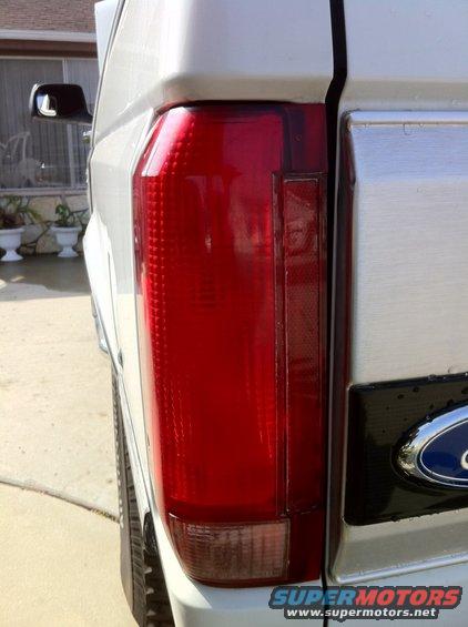

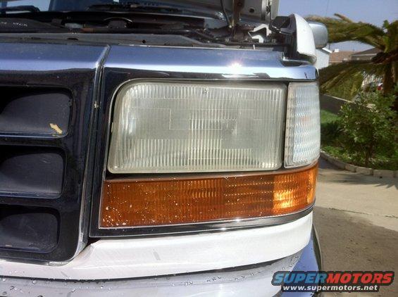

Here are my headlights and tailights before the restoration:
The process is pretty straight forward.
First you wash and dry the headlights.
Attach the buffing pad to the drill, apply some of the PlastX and work it in.
Then you wipe it off with the microfiber towel.
You can repeat the process if needed. (I need to repeat it because i missed some areas)
NOTE: i didn't do this but i will next time. Apply some painters tape or something similar to mask off the headlight bezel and surrounding pieces. The PlastX takes some elbrow grease to remove.
