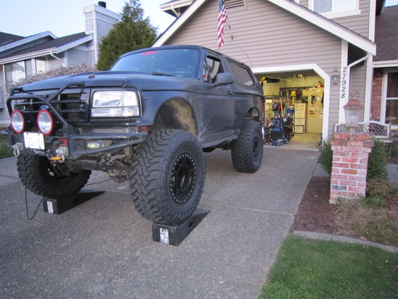

After getting hung up on my sliders a couple of times last year, I'd been thinking about doing a mild boatside/rocker cut. Started out by cutting along the lower body line. This was a royal pain to do. Came out in many pieces.

looks good! I like the how you kept the lines while still taking a substantial amount out. can you take a pic angled up towards the floor pan to give us some perspective?

Wow! Then I thought about it for a second; how did you seal up the door jamb/floor? Some time during summer, I'm heading up to your place. I always say this, but I'm serious. We can go wheel with Steve after the makeover.

That looks great. Can you get more pics? What does the interior look like?
