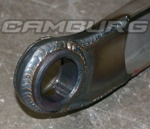

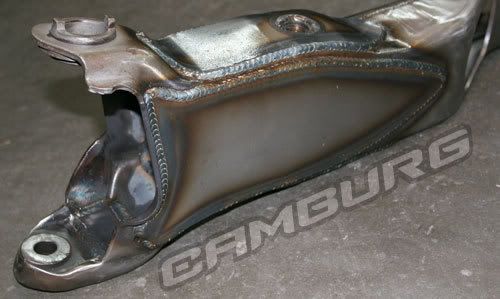

nice welds
I concur on the welds.

A real quick newb question... how do you get the metal to change colors like that? I know the welding will make it change a little, but is it just because the welds are so good? also, do you paint over those? I think the beams look look awesome.

The colors you see are the heat marks from the MIG welding. You can tell it's not a cold weld that way or triggered. That's what gives it that awesome look. Id like to keep them raw but they will rust quick down here by the beach.
