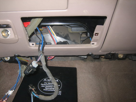

Here's what the Bronco looks like with the dash trim off:

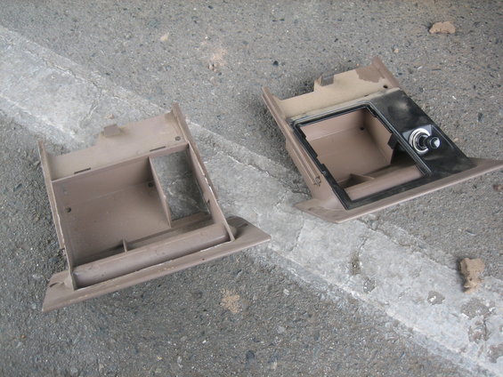

There are three screws holding in the ashtray, I took them out and cut off the left side tab, there are still 2 there if I ever need them. (half cut)
PNP donor ashtray:

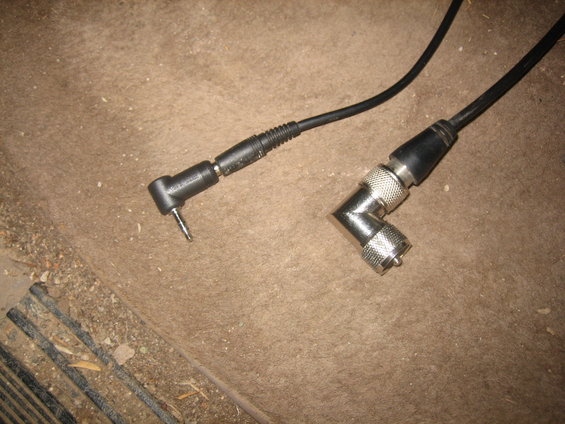

My radio was pretty long too so I got right angle adapters for th coax and PA jacks.
Left side tab all the way cut off
right side still intact:

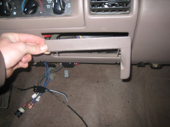

Here's what the donor ashtray was for, trim around the CB.

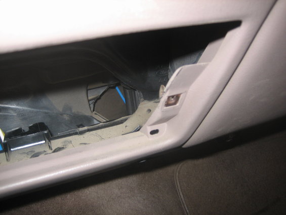

The heater duct needed a little clearancing:
quick test fit:
