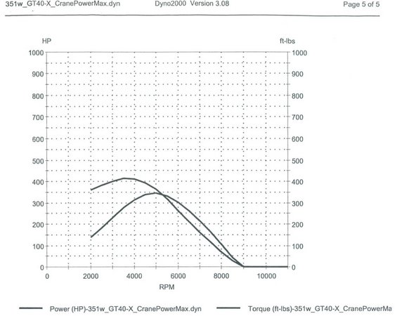

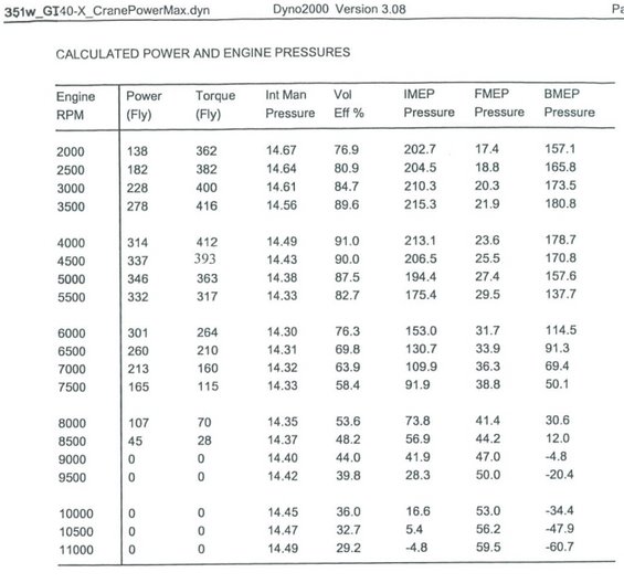

Hp/Torqe estimations by Desktop Dyno.

Scanned and added the print outs from Desktop-Dyno.
Desktop-Dyno is usually a little optimistic, so these numbers may be higher than what I will actually get. We wont know until I put it on a dyno.
