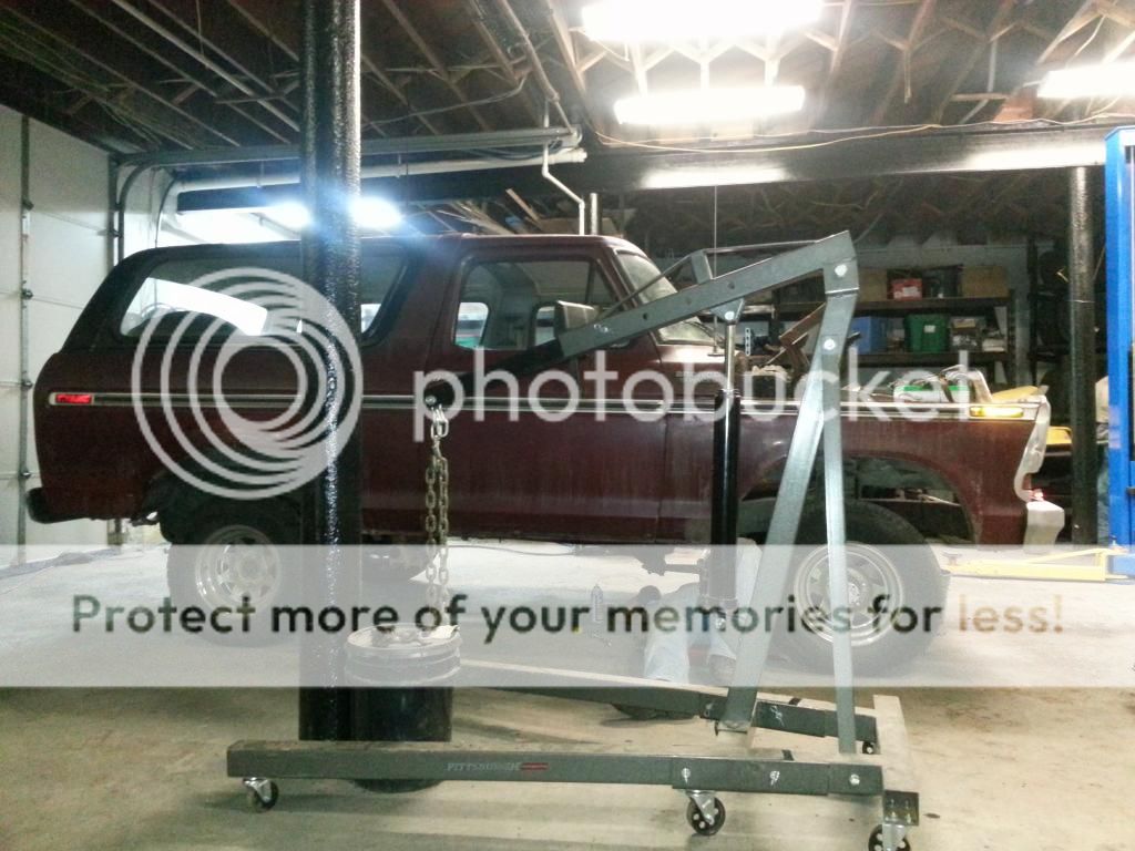

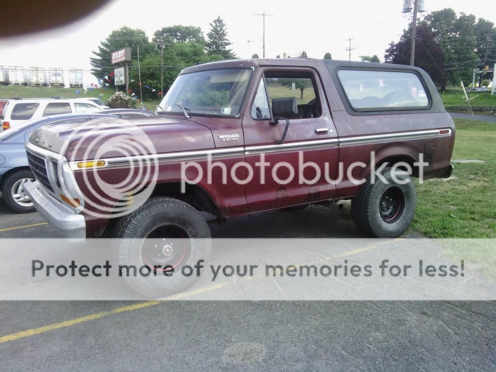

As promised, here is my 78 full size, pics of the motor swap and the new wheels.

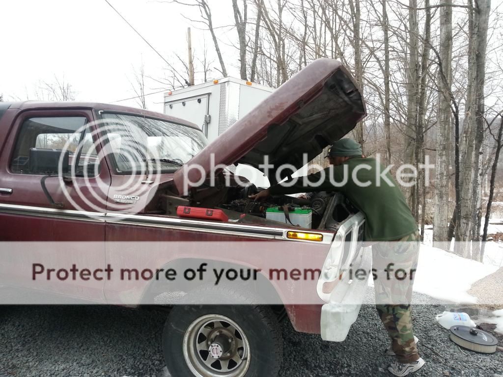

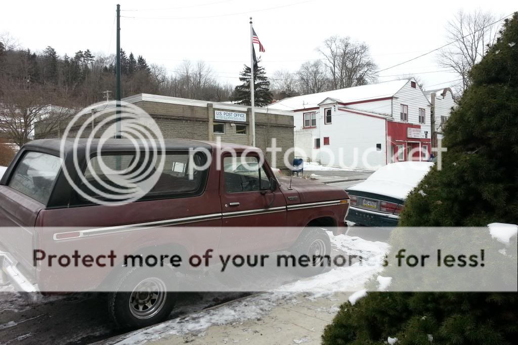

This is our Calamity Jane as she looked when we bought her, a few days before the 351m blew

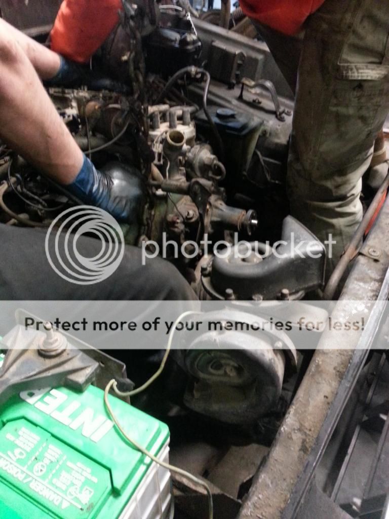

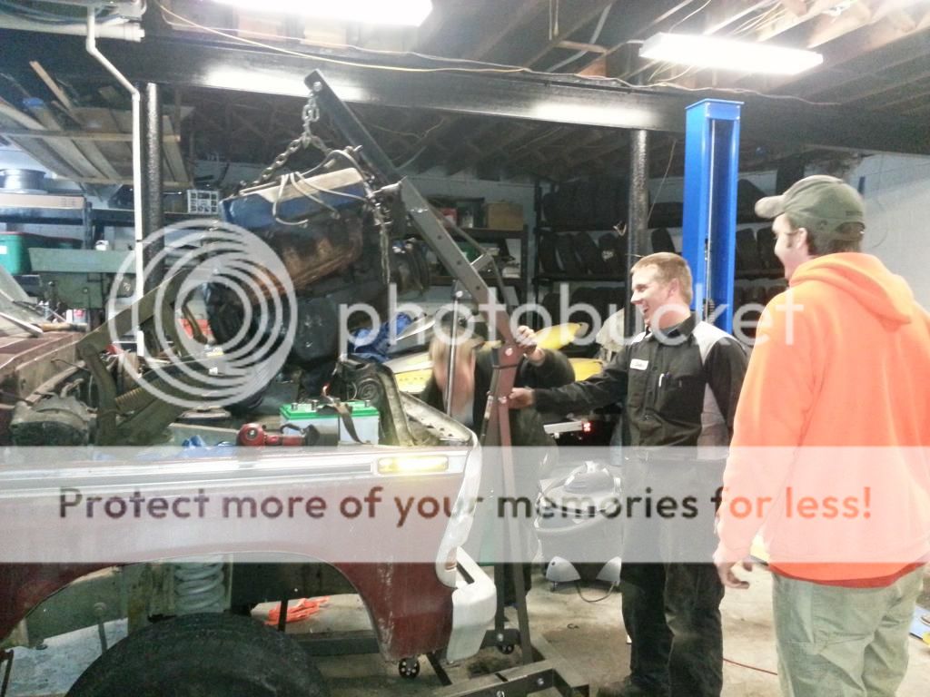

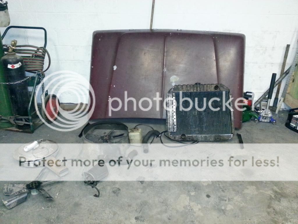

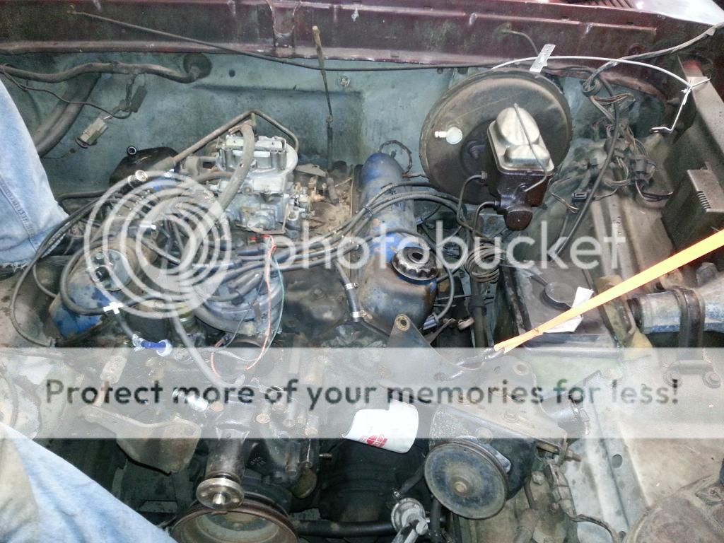

Prepping for the motor swap

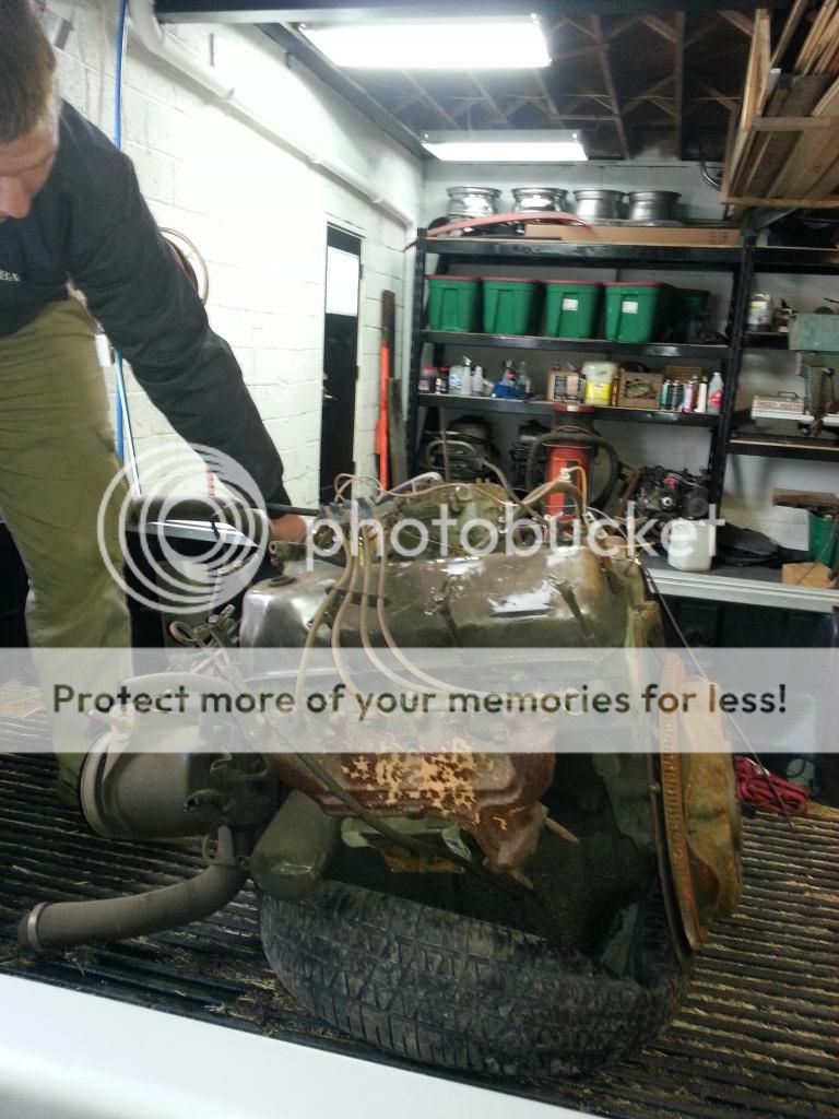

disassembling for removal

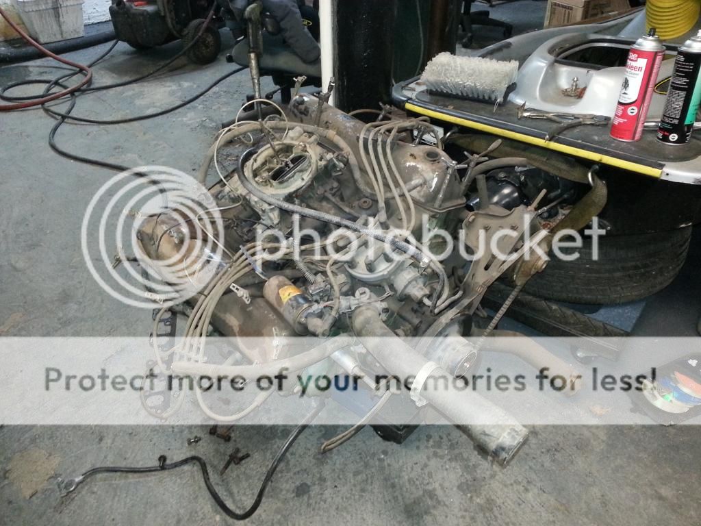

The donor, a 400m punched .040 over out of a 78 f250

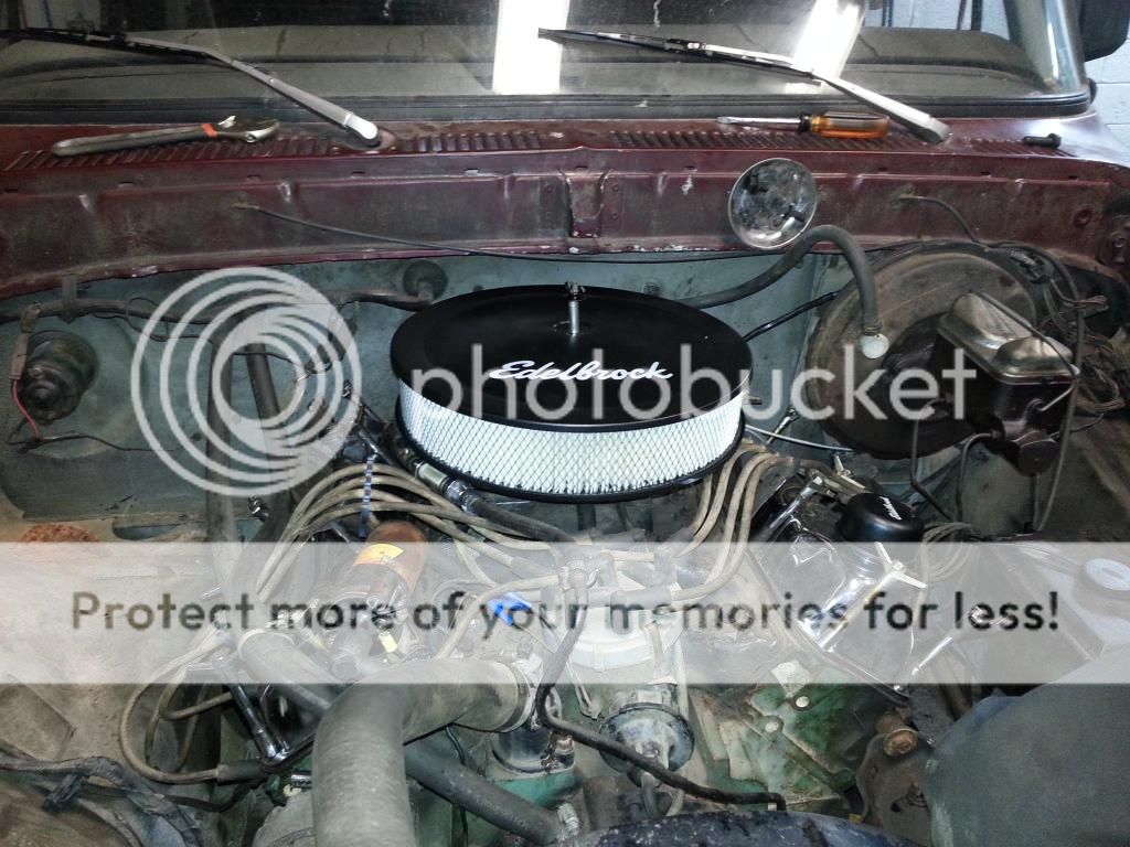

All hooked up with a freshly serviced Edelbrock 4bbl carb
Starting her up for the first time

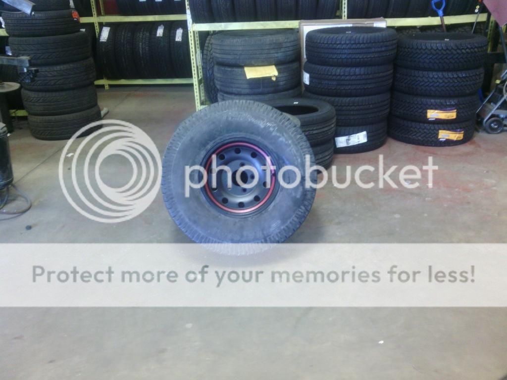

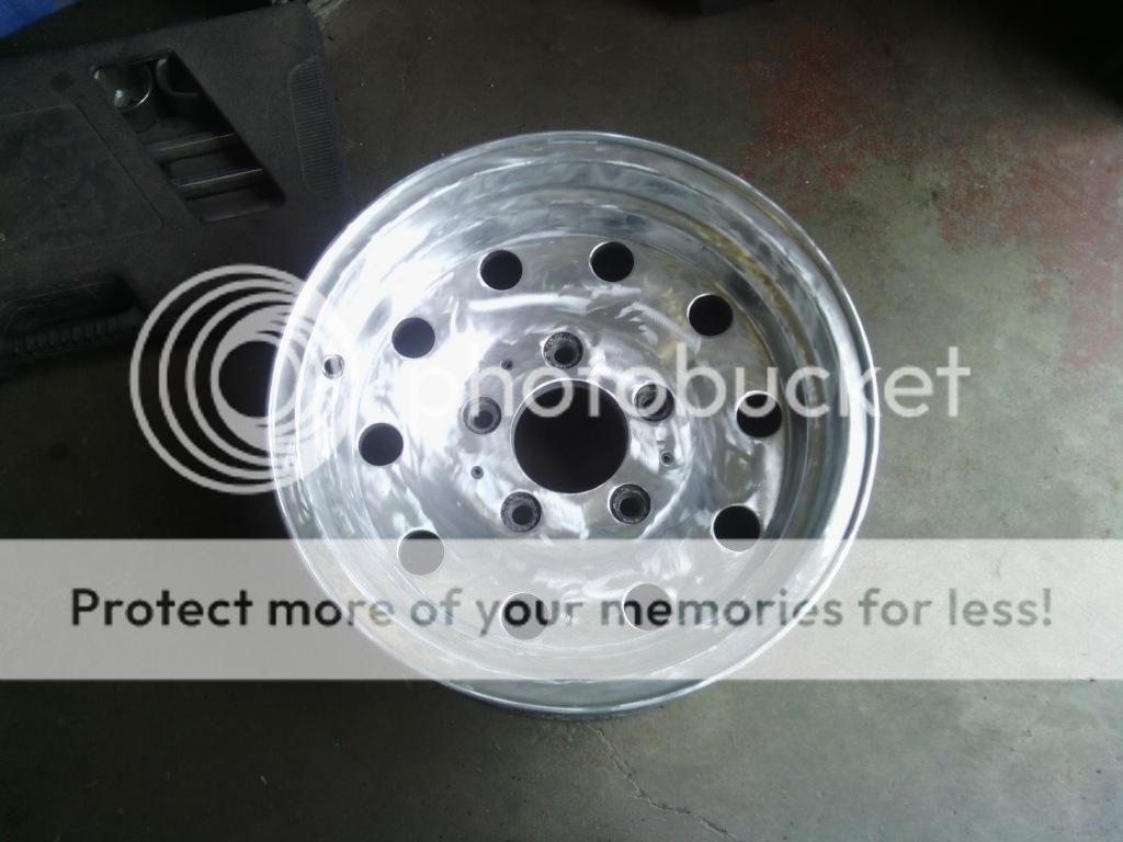

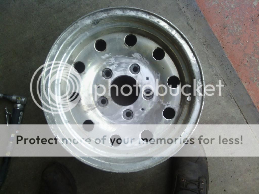

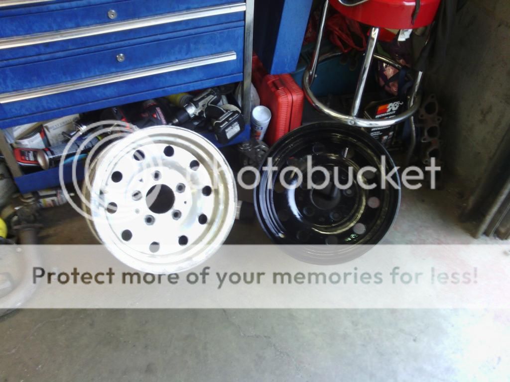

found four alloys for $50, considering my plans it didn't make sense to buy new ones.

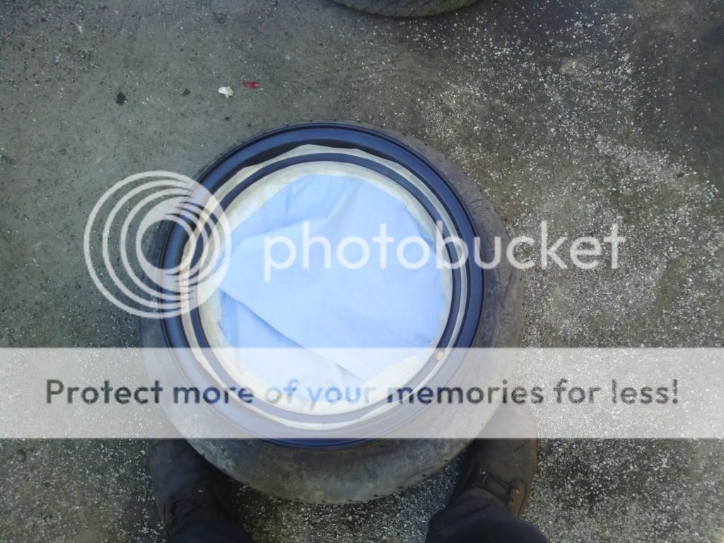

Finished and matched with 33s

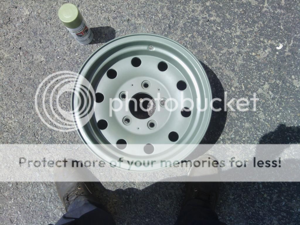

Here we are with the freshly painted wheels and better fitting tires. next step, body work and fresh paint for the truck

The oil pump driveshaft snapped and the engine seized. I was pleasantly surprised when I opened her up, I'm going to need some new rod bearings and to have the crank polished.... But theoretically I could salvage most of the original engine.
House of Windsor 4ever!
10,512 Posts
When you go to replace the pump drive rod, get a racing duty rod. The factory rods are the Midland's weak point. Also, If you go to put an aftermarket gauge on it, install it at the oil port on the top back, rather than at the block side port behind the fuel pump. That way, if there's another failure, there's a good chance you'll catch it before it totally fails.
