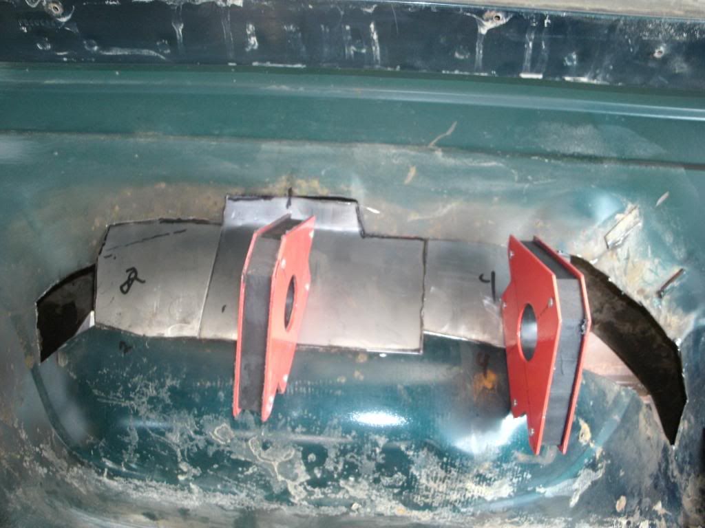

Well i have had new bedsides waiting for a year, and there was mud coming up through the wheel wells so time to fix. Of course I live in Canada so it is having some rust issues but i am cutting out all the rust i can. Dont be to harsh on the welds, i just got the welder and i am not the greatest and i havent welded since i was taught how in high school 6yrs ago. but i am getting there, here is what i got done so far.

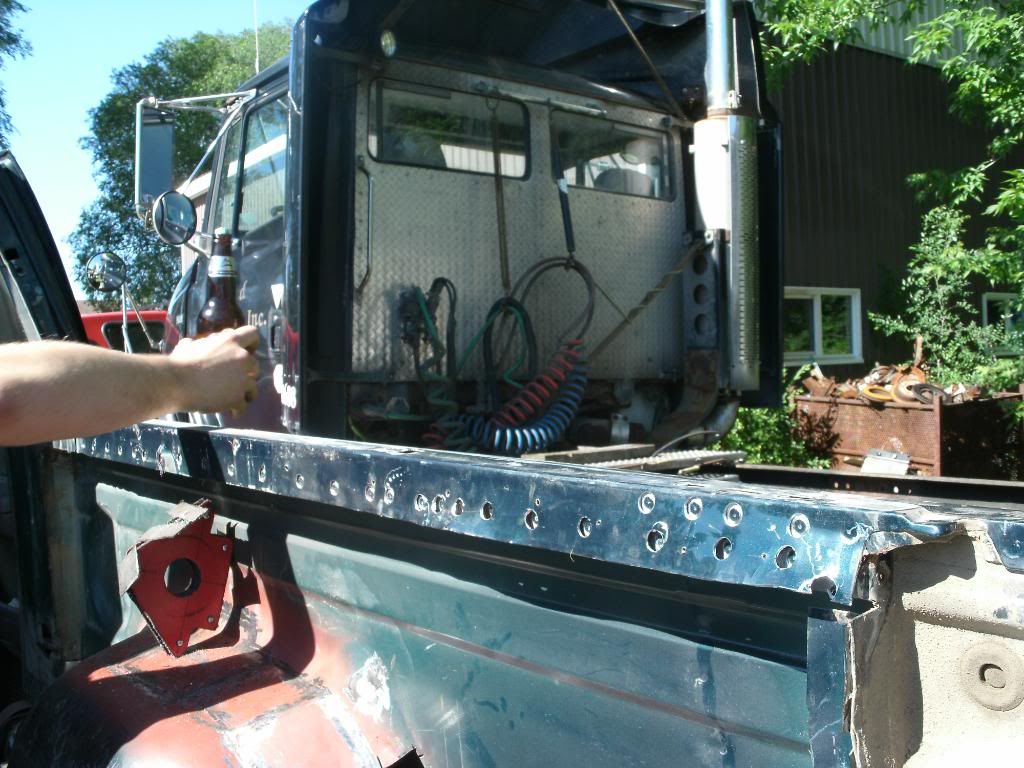

ok i went and took some pics while i wait for it to dry up out side. here is what it looks like with no more holes or rust, and you can see the 2 1/2" tube i put across the back of the truck
on the out side of the truck i still have to clean up some more, i want to go father under the truck with the bed liner its just to wet out to do that now.
next on the list is to clean the out side tub and bed line it, prep the inside of the tub to bed line it too.
