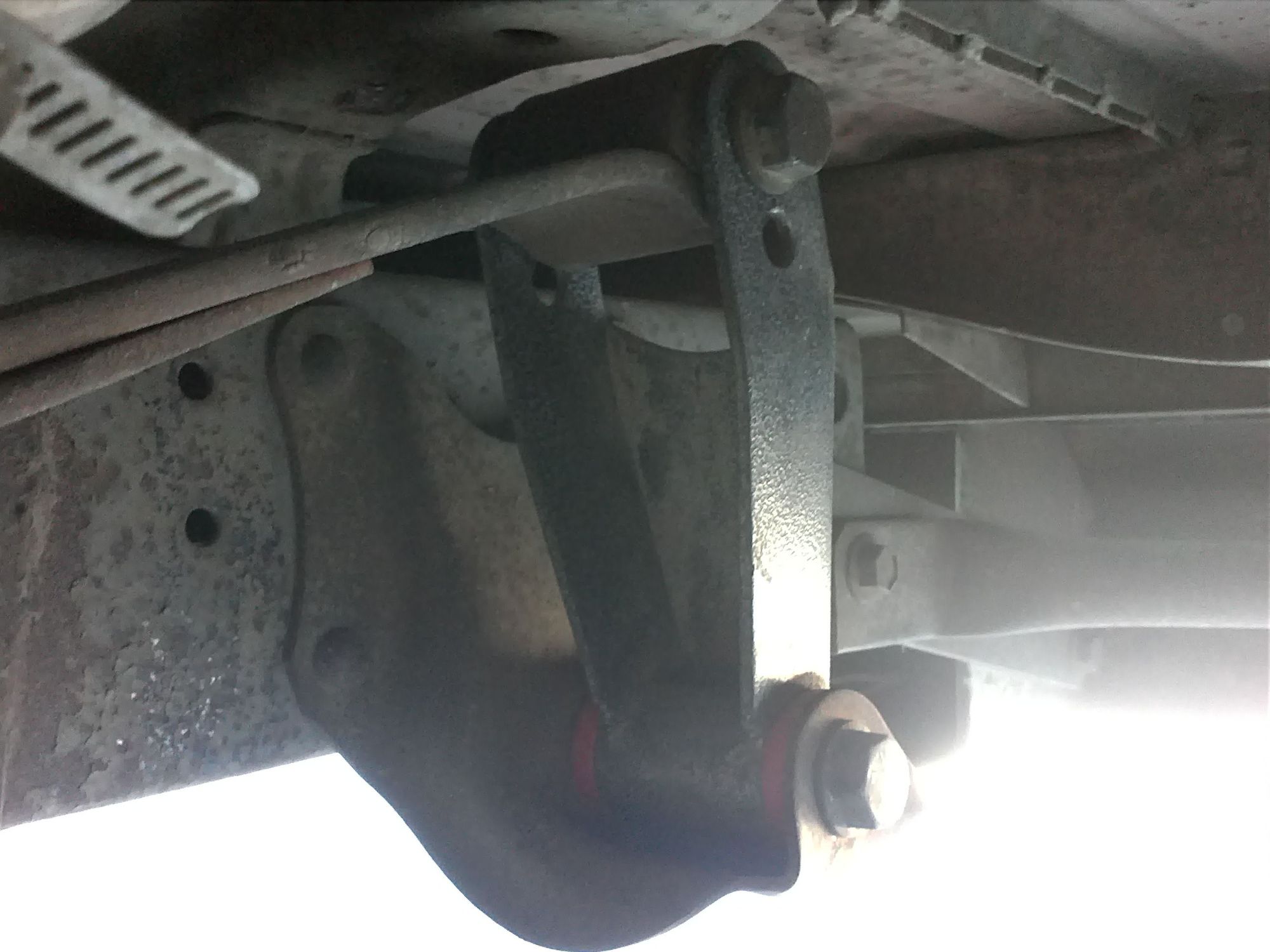

I drove it like that for a little while until I saved up enough money for a 3/4 drop kit from DJM which consisted of 3" drop "Dream Beams" and a set of 4" drop shackles and hangers for the stock leaf springs. I was a little leery of c-notching the frame, so I opted not to do a flip on the rear. Here are a few pics of the hardware on the truck.
Because of the drop on the beams, they add what is essentially a spacer to lower the tie rods. The tie rods go through the radius arms.

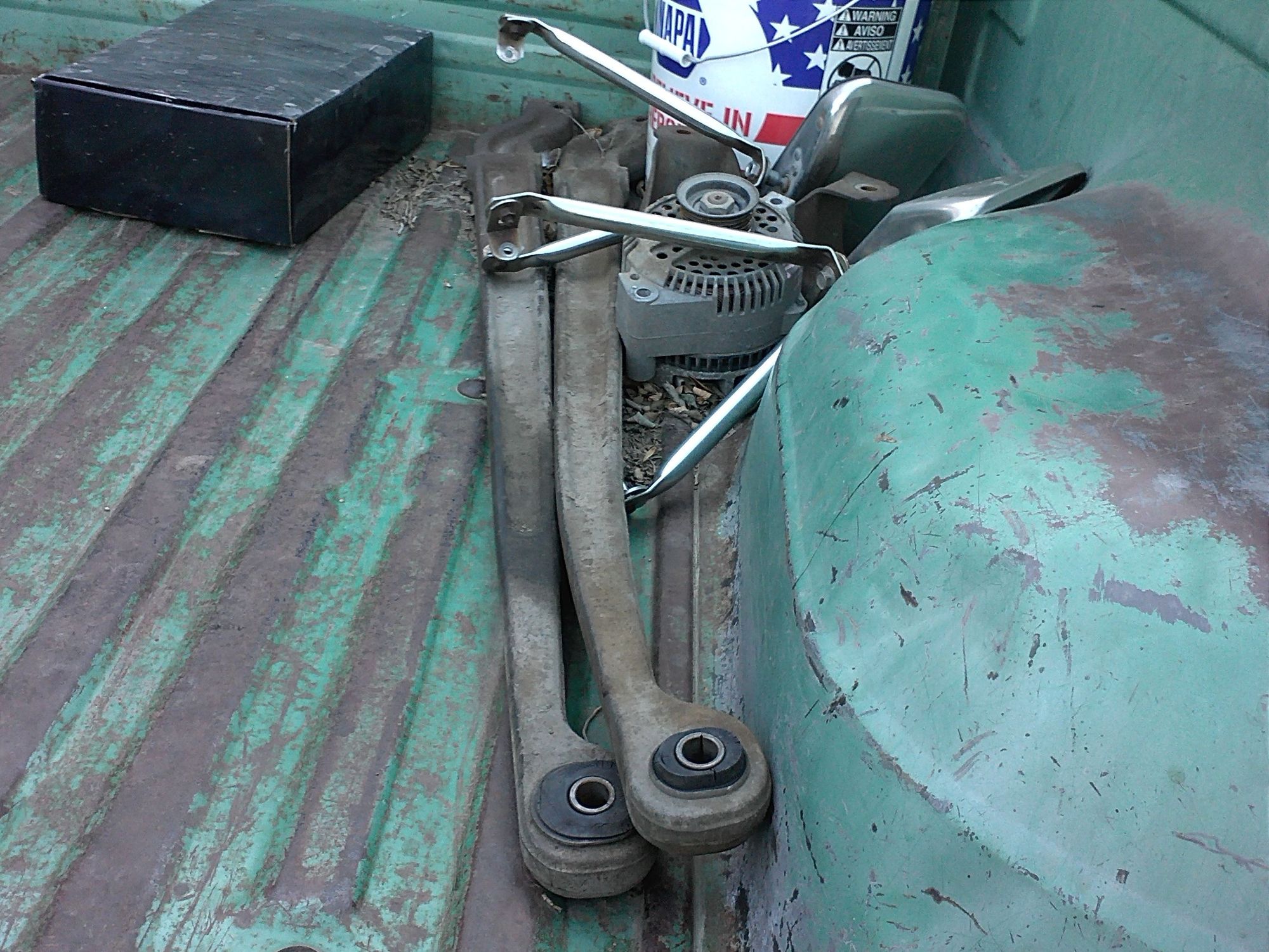

And since we're in the front end, I replaced the radius arm bushings and put on all new tie rods and shocks. I also replaced the steering gear to help tighten everything up.
It's hard to get a good idea of how much it dropped with the pics I have of it. I haven't really taken a whole lot since I've had it, but this one next to my Bronco when I got the Bronco gives a decent idea of where it sits now.
And, as I'm not one to throw things out too quickly, I kept the old beams, shackles, and hangers. I still have them laying on my porch juuust in case I ever decide I don't want it lowered with the Dream Beams anymore. You'll also notice the big mirrors that were on the truck are sitting in the bed as well. In hindsight, looking at this pic right now, I should have kept the mirror heads as they were in pretty good condition despite being ugly mirrors overall. They would make good backups for my Bronco, but that was a good few years before I got my Bronco, so that was clearly not on my mind. There's also a 3g alternator off a Taurus that was meant for the truck and a black box holding the old halogen headlights.
