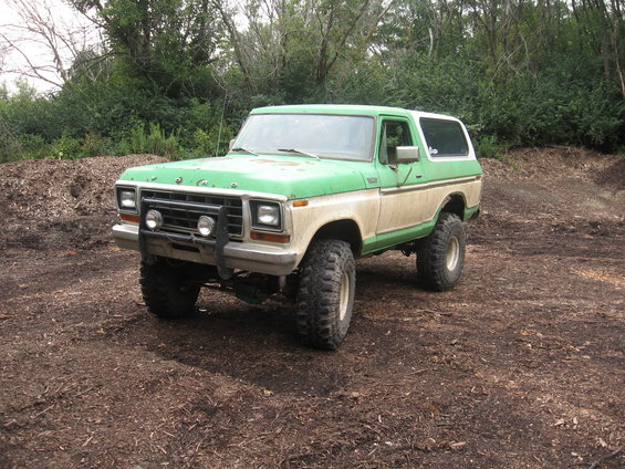

This is what i started with:

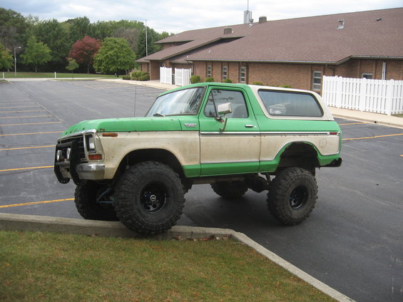

Is this the local church? Looks like the church has an RTI ramp! Nice Urban wheelin' pic!

Is that a 9" front coil and 6" rear leaf lift? Am I reading that right? I like the stance..
Yes your reading it right...But what you missed was the shackle flip for the rear...It should work out to aprox 9"
I like the stance now as well but i want bigger :toothless
