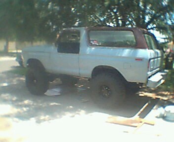

I really missed how i use to be able to drive the truck everywhere. This added to the huge stock pile of 78-79 parts I had laying around. So i scraped the built bronco, and started looking for a good condition 78-79 bronco.
I found a bronco from a friend of mine that was a second owner truck, that had lots of options from the factory like tow hooks, roll bar, rear sliders, locking gas cap, ford spare tire lock, 400 with headers and a cam. The main problem was it has some serious rust along the roof. WEll installed a 4in lift and some nice wheels and 315 bfgs on it.

Then a couple weeks ago i bought storm callers old bronco to build since the body was in much better condition. Since i bought the truck i have changed the hood latches,door latches, got some of the dent out of the passenger door, replaced the front bumper, converted the a/c to r-134a, replaced the cd player, and installed some 6x9's. I took it to a cruise and car show a couple weeks ago and it averaged 10.3 miles to the gallon at an average speed of 70. BTW, this bronco has a 351,c-6,205 with 4.56's rear detroit, and 37 in mtr's.
I am currently trying to sell the tires to get some 36 or 37 iroks on 17 inch wheels so that i can use the wheels on the above stated bronco. Also i am thinking or swapping to the 460 quicker than i imagine since the 351 has little to no power.
