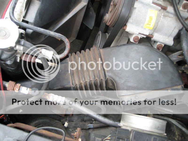

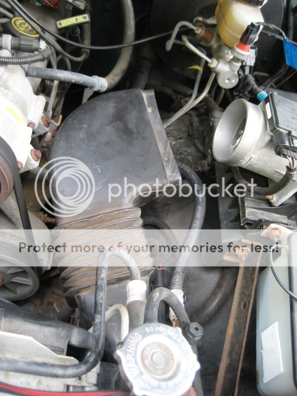

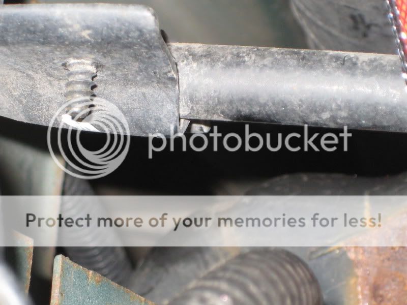

on mine I had to cut off the end off the air tube to make it flat and ride up against the core support. just took the hack saw and cut the end the curves off,

should work perfect lol and seems like it did, no problem! There is my one contribution so far! :thumbup
