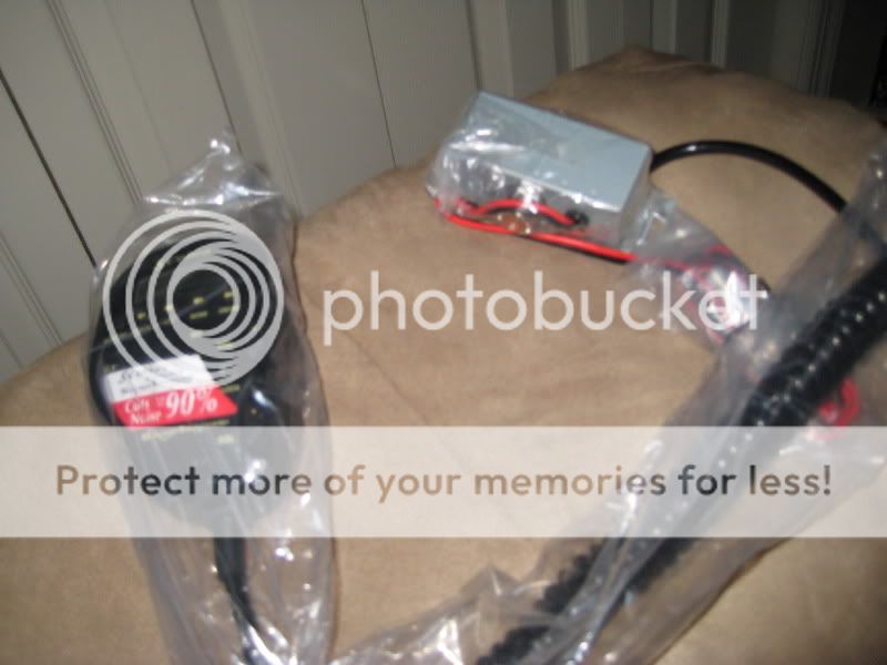

My cobra 75 came in today, i was messing around trying to find a place to mount the box but i have no clue.... I thought i found the perfect spot inside the dash behind the cubby hole (the one by the steering wheel) but when you put the panel back on it hits :(.....
I don't know where to mount it now, but I want it hidden.... I was thinking the center console, and i could run the wire out the side and it would be right by my drivers seat..... But that leads to, where would I wire it to? I want to tap into something that is only powered by key on, not constant on.... I wanted to tap my radio wire, but damn if i cant get the stupid thing out... (I'm a mess, I know :rofl:)
So, I need some ideas, I've never messed with CB's before so this is uncharted territory for me...
