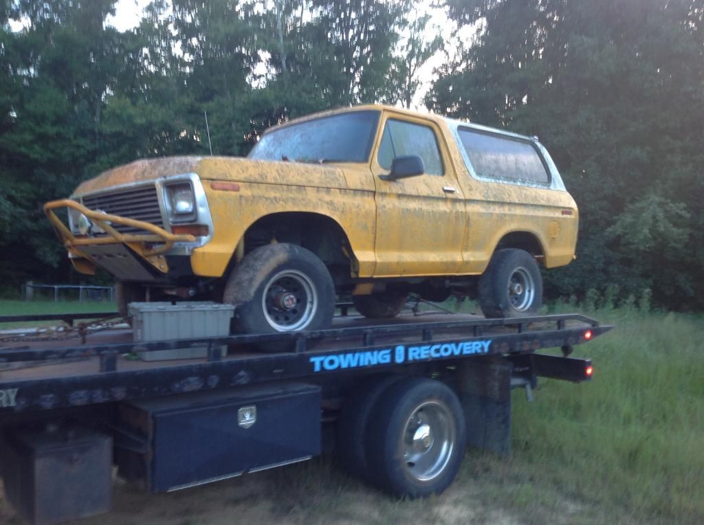

I did some horse trading and now the proud owner of one 1978 ford bronco. The truck has been sitting in the woods since 2008, the best part is the truck was transported east from escondido ca in 2006, the paper from the shipper was still in truck. The truck has zero rust and somebody did a a good job on fixing it up. Let me know if anybody remembers seeing the truck or a thread on it.

Not much as of now other than get the mold washed off. it is an june of 78 model tilted as a 78. The build sheet was in the floor and square headlamps was a option. The truck looks in great shape other than the front fenders being cut. Don't know to much yet as i just got it in trade for swapping a motor in a 4runner. The trim code is a EA1 is that a custom?

Got a chance to check it over some, I think it will clean up good. It i amazing to see one of these trucks with no rust. The carpet looks factory and the door panel's are the fancy one's, but i still don't know if it is a custom or a higher model.
1,417 Posts
going by the pictures with the door panels and dash trim I'd say an XLT. Door panels are an easy swap, but the dash trim is a PIA to add. Doesn't really matter though. other than a few dodads pretty much everything important like driveline options could be had on a custom and an XLT. post the VIN from the DS door opening and the codes. it will tell you what motor it came with and the door trim tag will tell you axle codes and if tilt steering was present when it was built. OH!! FYI the mirrors aren't stock so there has been some body work done. I bet if you pulled off a door panel or a rear trim panel you would see where the trim retainer holes has been filled. Also the speaker hole is custom as the stock ones were behind the door panel.

It has had some work done to it, but the body work looks good all the panels fit good. By the vin and parts of the build sheet it was a factory 351. No tilt but it is still the factory color chrome yellow.
