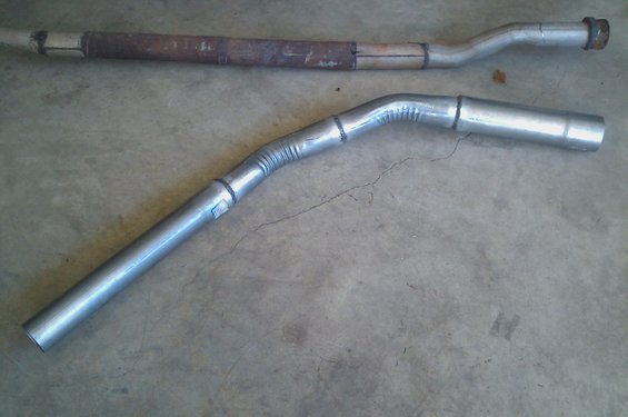

My brother and I were sitting around at my house looking at the bronco and started talking about what i was wanting to do with it. After talking about it for a while we were bored so we decided to change it.

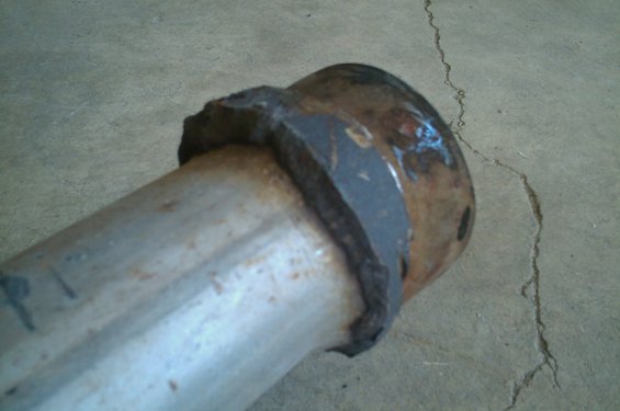

The main reason for this was it had some pretty ghetto exhaust work done to it
It came out of the cat at 3", then they welded 2 1/2" into the end of it, then farther down it eventually turns into 1 7/8"
With that, the truck had absolutely no power
We cut that off at the 3", and drove it to town to get some exhaust pipe and it felt like i gained 50 hp the way it took off!

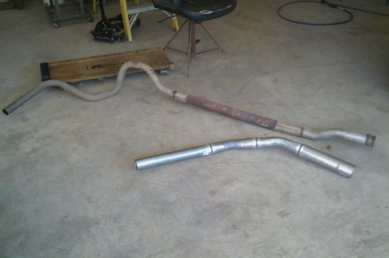

After playing in O'Reilly's for a while this is what we came up with (the exhaust shop was closed)
Definitely an upgrade :thumbup
Comparison:

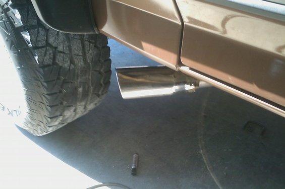

Here is what it looks like on the truck
Sounds MUCH better to, there is an exhaust leak because on the very last weld we ran out of wire (mig welder):banghead, so there is a half inch long gap that i have to weld up this week

good job on taking matters into your own hands fabbing up something the way you wanted it to be. I'm personally not a big fan of exhaust that exits in front of the rear tire, but its your truck and to each their own I guess. Looks good. I'll be waiting for you to post up a video

Yeah, I'd only do it on a 300.. If i had a v8 I'd put duals out behind the tires... but its an inline! I'm trying to get the video on supermotors right now, but i think i'll just put it on youtube and be done with it

Local shop here charged me $10 to weld the gap that i couldn't finish at home :thumbup Sounds a little better now and I don't get a headache from exhaust fumes anymore :toothless

LOL yeah, we just sat at the exhaust area and started sticking things together, i gave them my drivers license and they let us carry it out in the parking lot and test fit it. In the end we used 2 45 degree bends and two straight pieces of pipe
