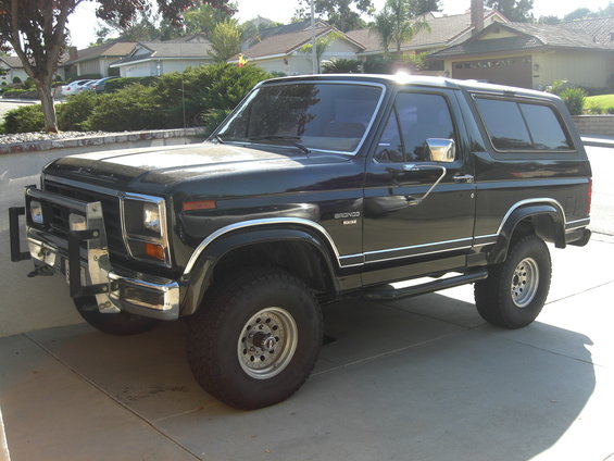

Figured out how to post pics. So this is hopefully my before pics, and ten years from now will be the after pics. I want to remove some of the 80's cosmetic stuff but it's kind of funny and reminds me of high school.
Looks like a decent starting point. The axle-shaft rubbing is a geometry issue. Enlarging the hole in the beam would just be masking the problem.
Is there a way to correct this without going to an Autofab setup?
What else are you wanting to do to it?
New radius arms, shocks/ buckets are the plan. Also should I run with the drop pitman thats on there or swap it for a stock one, I've heard arguments for both.
Broncos don't leak what's that pan doing on the floor? LOL. My 1984 leaked like the Exxon Valdez. Nice rig 84. Don't update that front end. Autofab has some really cool fenders and hoods for 1980 to 1986 Broncos.

It seeps all fluids known to man, nothing to major just annoying. I'm putting in a new radiator in the next week or two, getting sick of maintenance stuff that gets on the way of cool stuff...
The front end will stay stock width so i will run it as is...
