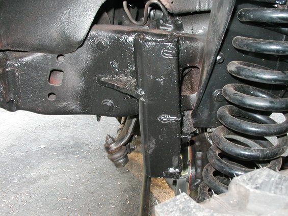

I wanted to strethen my gigantic trac bar mount, so I gusset'd the front and back of it with some 3/8' steel...

Why more gusset on the top Tbar, looked awefully strong to begin with?

I gusset the mount just incase. I didnt know if the mount wieghted to much to just have it welded like it was, I just wanted more strenght from forward and rearward movement. I just wanted overkill i guess, lol....
