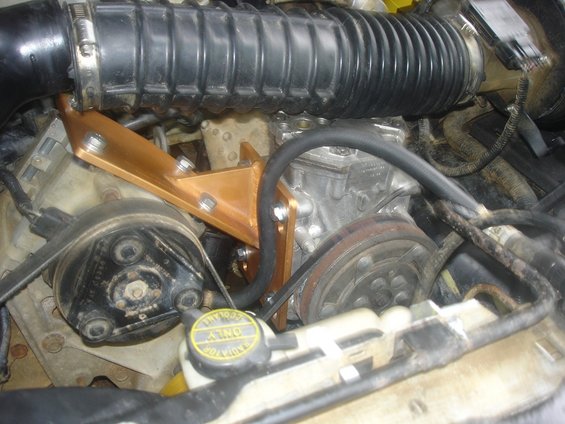

There are a few write ups on it, so i will just throw up some pictures of my setup.
I used the BroncoAir Kit. This is a York 210 from a late 70's volvo.
Here is the intake filter and fitting. I used the stock hose and attached my filter to that to save some coin.
This isnt a great pic, but its the filter and Check Valve. You can look around them to get a feel of exactly where its located.
Here is the manifold that has the safety valve and the drain valve.
This is where i mounted my gauge. Its visible and legilble from alot of positions.
Here is the 3 gallon tank mounted under the bronco under the rear seat.
It has lines that run to the front and back of the truck and has an air pressure switch too. There are more pics of those and more on my superford. There is also more detail on my setup.

Do you have a saginaw power steering pump tucked in there too?
I got the part number from Dogonmut, so i bought it new but its a saginaw type pump for bronco/f150 IIRC. It is incredibly quiet, and looks like a saginaw pump, but i didnt need a new bracket, so im not for sure if its 'real' saginaw.

You can buy a compression fitting for that stock AC hose (cut off the rubber part) and screw it onto a NPT fitting with a barb the filter can fit on. Clean that electrical tape up a bit. Other than that, it looks great.
