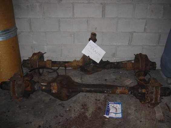

when i brought the axles "home" to the loading dock at school. my buddy thought we could put them in his closet. seemed like it would be hard but i figured it was a deal and i couldn't pas them up.

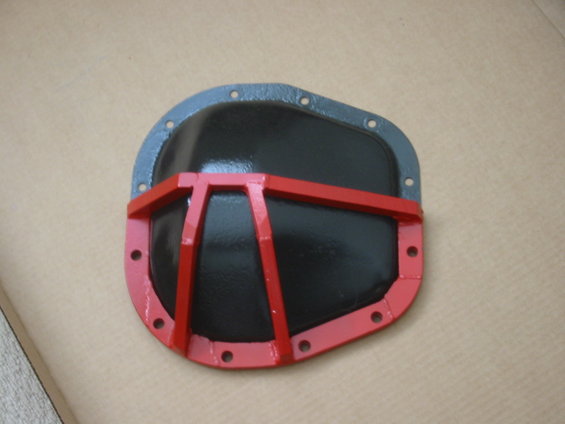

started on a dif cage to protect the rear R&P
you still get to laugh at me learning to TIG weld

lol the sign. apparently the guy in charge of that building was trying to figure out who (of the employs) left those there. and had told one of the guys on the school racing team(that i was part of) that he was gunna throw them away if they weren't gone the next day. so i made a sign with my number and left them there for a week.
