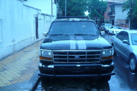

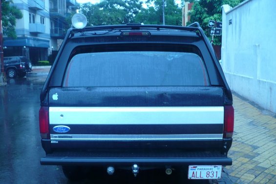

I am from paraguay , and since a a few weeks proud owner of one of the two remaining bronco xlt s , mine still has the original engine winsor 351 engine and was build in 1992, she comes with an additional liquid gas tank . I bought her from a rally team who have no use for her anymore . I used to collect watches and when I saw the bronco It was love at first side , i exchanged her for a rolex submariner . I especially took up driving lessons to enjoy the purchase , my knowledge of cars is zero .
current status
The current state of the bronco is engine works , she drives , lights works , brakes works , 4x4 function I am not sure , , on the dashboard only the rpm , the odometer , the battery meter, signal lights works , the rest is not of the meters are not connected or not working. The engine check light is always on , and the rear abs light is always on .
Transmission
Automatic transmission , work. I have not tried the 1st and second gear yet, when driving on petrol she makes a bump , when driving on liquid gas the tranny works smooth with out bumps
I have decided to invest money in my new bronco and find a good mechanic to help me out only I have no idea where to start , or to begin , any sugestions and tips are welcome . Mind you all I do not have acces to so many supplies as you all do , but I figured there are a lot of ford pick up trucks driving around in paraguay , so i can get spare parts from those
