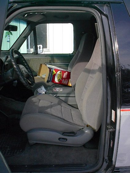

I installed a pair right above the top of the door trim. Same as on the passenger side..
That looks nice, where did you get the handles from? How secure are they? Did you just use sheet metal screws to install?

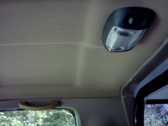

Can't see too well from the pics, but I have them mounted to both a-pillars and one on the headliner above the passenger door. They came out of an early 90's taurus. For the a-pillar mounted handles I had to make a couple of brackets and weld in behind the trim so I would have something solid to mount them to
2
Nice overhead console. The handles look like a clean install too. :thumbup
Thanks, when I find my digital camera I will get better pics of them

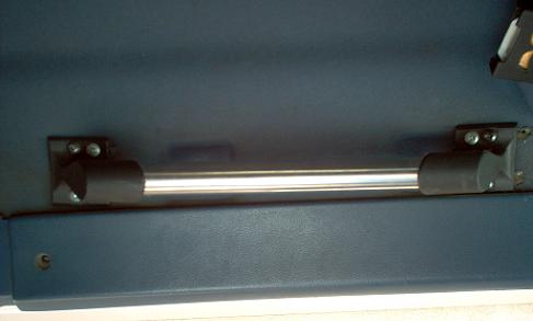

You are correct...Exploder handle, and only had to drill one hole to mount it...:thumbup (although it's gotta come out soon for the cage..:brownbag)
Here's a shot...my new model interior light is in the forground and the handles in the back ground..:rockon
What you do is take out one screw from the trim piece, and screw it through the handle back into it's hole...then you use the other hole as a template to drill your other hole (watch it closely, cause you could "not hit the meat" of the shell...very easy as long as you are aware of this...when you do it you will see what I mean) then just use one of the screws that came with the handle and fasten it down...that handle cost me 5 bux at "the yard" and it was the correct color! :thumbup
(There was actualy two handles for 5 bux, but I gave one to Oscar so he could do it to his rig....hey, I wonder if he ever did that???)
