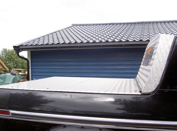

davids78bronco said:
very nice....but that defeats the purpose of no top....
except that is gets the fastback look with a sealed top that was custom so im sure people love it... i know i do...
and it still allows for removal and is prob easier than the old top for one person...
it can still be removed...

screw a soft top that metal fastback tops sick. im gonna make something like that for mine and i bet it doesnt cost me an arm and a leg

Saw a guy that had a metal top like that Saturday in Oskaloosa, IA. Did a double take...wished I could have snapped a pic.
