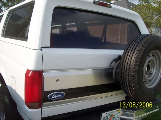

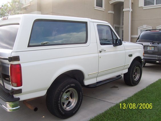

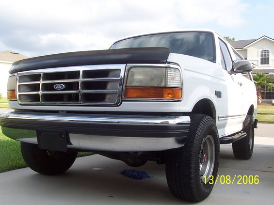

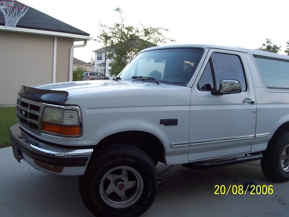

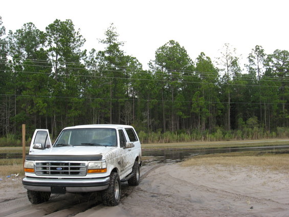

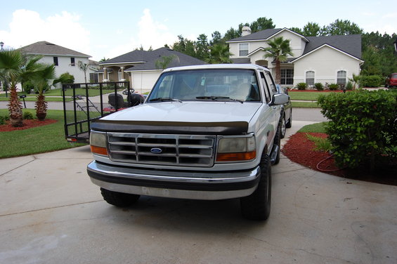

heres what im starting with: 1994 bronco XLT:thumbup,fully loaded. 302 5.0 factory maf. stock except for 32" M/Ts. this build will be done for Fuel efficiency and off road capability. the fuel efficiency mods will come soon. for now heres some pics:
first day she came home (4 years ago):
some off road:
as she sits:
she needs some love:whiteflag

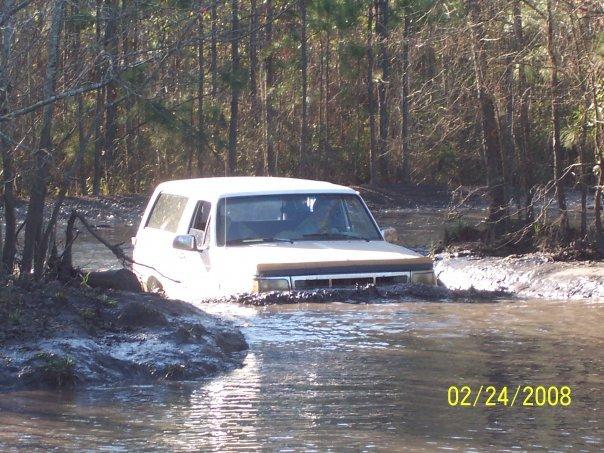

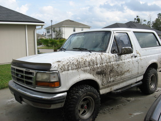

Where in JAX are you and where are you in those offroad pics?
in in fleming island on the southside. the first one is from a mud bog about 30 minutes out towards middleburg. the others are in a feilod we have here on the island. its vacant and not posted so we use it for our toys.

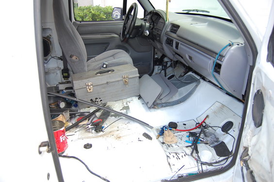

took some pics of what little progress i made, i didnt start till late and it looked like it was going to pour.
got both seat belt back in. used blue loctite on the bolts with dielectric grease around the flange to make it watertite.

well it rained like hell today so all i got done was the new fuel filter, the stuff that came out of the inlet of the old one was black. after it had been raining for a while i went out to the bko to run some errands and i found this:
i dont know if you can see it but theres still some water left in there. when i came out it was about 2 inches deep in the b pillar corners. the truck hadnt been driven since the night before (it was dry then). so it appears i have a leak. i checked the rain gutters and they look like this:
the outside of the b pillar is dry so i think its running down the inside of the bpillar and then coming out of that square hole at the bottom. the water didnt drain either (cause the floors all sealed up:thumbup), it just sloshed around and out of the corners while driving.
