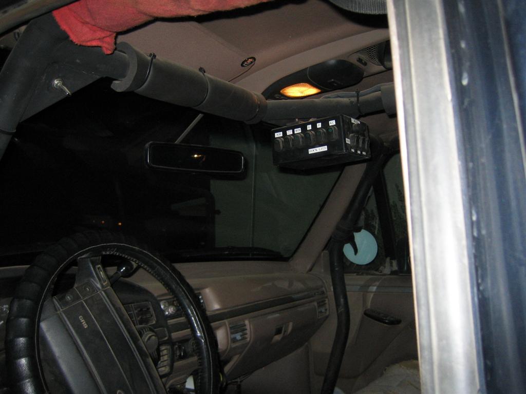

Silver 2 pole switch on top left is the interior control for the winch. It only has power when the ignition is on and the "winch switch" is selected on the main switch box.
The main switch box is mounted to the roll cage. It houses the following:
Front of switch box:
-Main power to all the switches
-ARB pump
-front ARB
-rear ARB
Side of switch box:
-air compressor (when the OBA is hooked up)
-Under hood work lights
-interior winch control
-rear rock lights
-front rock lights
-KC's

ToddACimer said:
Dogonmut nice overhead console
Thanks
ToddACimer said:
above the roll cage
It's under the cage and protected quite well
ToddACimer said:
you should have yanked it out and sold it to somebody
Huh? If I did that then how would I control my gag? Again...huh?:scratchhe

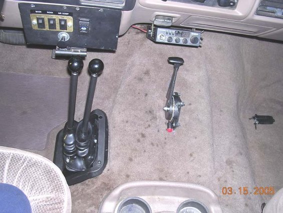

funny you posted this up today. I just finished fabbing my second panel up today. the paint is drying as we speak. i will try and get pics up of both panels tomorrow. here is my old panel
ok i give ..........whats the one all by itself in the middle?
and have you thought of usin the stock 4x4 switches for anything Damon?
either a doubler or locker
I'd venture a guess of a hand throttle
Klune-V 2.7 doubler
To prevent the next question about the other 2 shifters...it's a twin stick 205 transfer case.
He sucks.
BTW Plug...are you ever coming to AZ to do some wheelin' or what?
dogonmut said:
Klune-V 2.7 doubler
Correct. The one in the middle is the klune shifter and the two to the left are the 205.

the stock 4x4 buttons have been eliminated, as was the stock rear defroster button (that now retains the new adjustable throttle).
The old adjustable throttle is the little black knob on the lower switch panel. its kinda hard to see, but cost 8 bucks, its an adjustable choke that worked for years. ive gone with a new, more costly, and more accurately adjustable vernier throttle. ill post pics tomorrow when I put everything together.

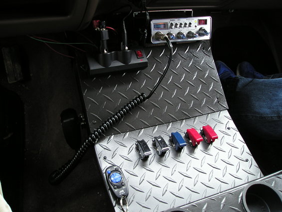

damn that's looks sweet Marauder. Did you bend the edges on the end of that console? I see the first two sections are cut, but i cannot tell what you did to the edges on the main sections. Really sharp looking, man that would be sweet with the door kick plates and tailgate.
