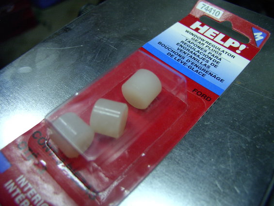

I did a search and I just want to confirm. I ordered a Torque Pin replacement kit with the gear for about $20. The problem I have is the Passenger Window is slipping and sometimes needs help manually to get it up. The rear window is not moving now at all but the motor is turning. From what I have read this is a common problem and the torque pins need to be replaced.
Did I order the right thing? Are there any things I need to know before hand that will save me some hassle once I attack the problem? The reat window is stuck and will not close all the way, so I need to get that one done soon.

Six - It worked. I first did some adjusting with the screw, did'nt seem to help. Then I gave it a few taps around the canister and I got slight movement. Form there I played with the screw and kept tapping until it was constent. The same thing probably happend to my other window motor a few years back. Good thing I kept it...you never know what parts you can salavage. The torque pins on the "removed" unit were in better shape then the ones I currently had in. So I swapped them out, slammed some grease in, installed and voila! Window working smooth!
Lessons learned...a summary:
1) Before you think your motor is all bad check the torque pins and gear
2) Work with the adjusting screw
3) If that dosn't work...tap it with a hammer...man's best friend!
4) Always save parts that may be useful down the road!!!!
Thanks everyone...you just saved me $35-$45! :)

thanks for your help xris, and to stagmata I think it was, who had the write up. I got a new one for 58 bucks plus tax at Autozone today, and its installed now, works great... Although it looks like it was the pins in the other one, so I could have just got the pin set, but we live and learn, I'm just happy its working
Did you have a core return? Or do you still have the old motor? If you still have the old motor spend a little more, get the torque pins and have a back up! The passenger side window motor also is a direct replacement for the tailgate motor...just an FYI.

Another one added to the list. I took apart the motor and used adrianspeeders photos as help. Perfect. The torque pins are 7 dollars now by the way but after spending 7 on pins 3 on litium grease and 5 bucks at an auto hobby shop for the garage use. I came out with a working window for 15 bucks. Thanks for all your guys help. I took lots of pics but my blackberry sucks and could not upload them.
