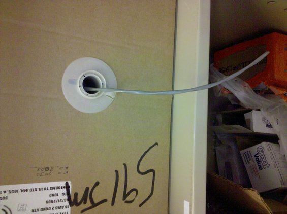

I am installing mass concrete sensors at work and am using this wire for my extensions:
Without using a knife (and a romex ripper is too big) what is the best tool for removing the outer sheath on this stuff? I have been using the serrated edge on my pocketknife but that is donezo as soon as safety or one of the big dogs sees it.

It looks like 18-2 to me. 10-2 doesn't come in a reeel-pak box.
Look at the label in the picture.
