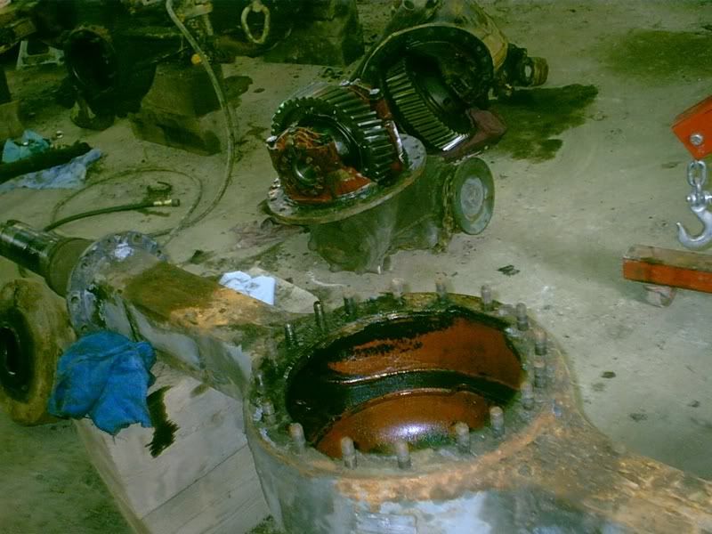

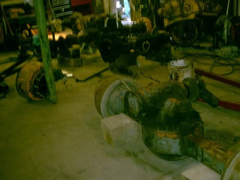

since the other thread was closed here are some pics of his parts and progress
front 5 ton
rear 5 ton
dissassembled rear 5 ton

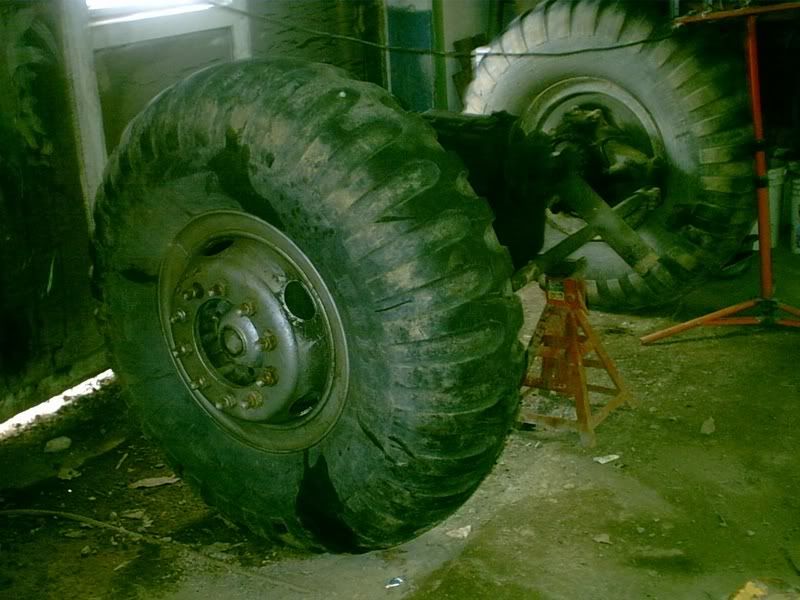

the old 2.5 tons after removal

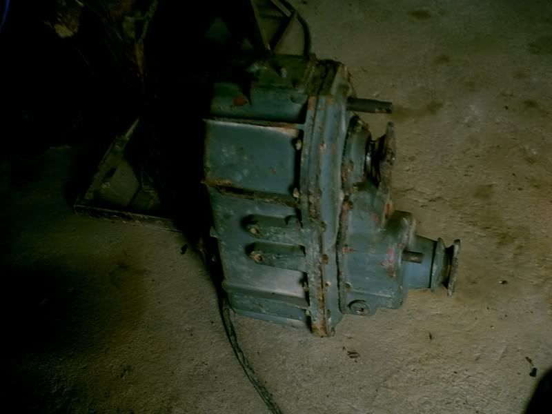

the finished t-case (rockwell T-136-21)

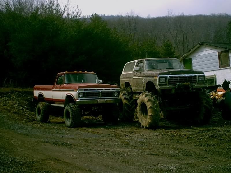

and a pic of mine beside my other buddy's 76 still origanal paint and sheetmetal
Just had to throw that one in there:chili:

that 76 looks damn sweet
