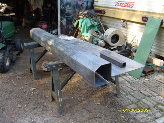

So I got the plates and stuff today here are the pics so far
I will start tomorrow. So far the cost is 274 for what is in the photo and about 100 for lights, I will take pics of later.
I expect it to cost between 600 and 700 for materials when I'm done. I hope people who scoff at quotes of a grand or so for a bumper take note, because you can see now that it is not cheap to build.
I hope to have the bumper mounted (minus tire / jack all / shovel / gas can carrier) by next weekend just to give myself and others an idea of how it will look.

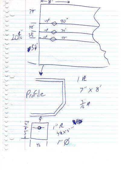

here is the dimensions I used (overall is 20 5/16" x 8')

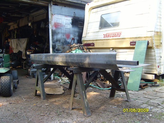

So I tacked it together to get most of the shape i want, I still need to remove the stock bumper in order to use it as a template for the cut out on top.
I grabbed my #3 tip for the heating and to show you guys the difference in size from the 3 to the 6 (with the 6 on the left and then top shot shows 6, 3, 1. The front close up of all three turned out blurry)
and here it is all formed and almost ready for fit up on the truck.
