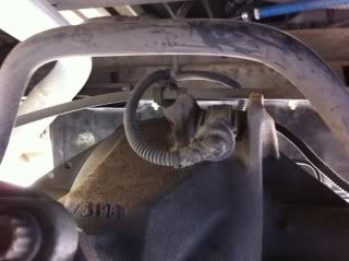

I am a little slow so what are you holding in your hands? I just changed the ball joints on the drivers side and had to destroy the abs sensor. I have to leave Friday for a 12 hour drive to school and don't have the money or time to try to replace the sensor before then. I just need to disable the ABS system until I can get the money and time to fix it. The problem I am having now is the brakes pulsate and I tried to disconnect everything I could so far. Both front sensors have been disconnected, the cable going into the brake booster, the control box on the inside frame...what else? I understand the back brakes use the same cable for the speedo as the ABS? What am I missing and how do I do it? thanks.:banghead
The cable for the rear brakes...do I have to disconnect? Will the speedo work?
Disconnected from the master...
Pass side sensor disconnected...
Driver's side sensor cut...
Computer disconnected on the frame rail...
That's not the 4WABS computer. That is the 2-axis accelerometer (although technically it's just a pair of switches).
Ok if that is not it where do I find it? What is the 2-axis accelerometer? Thanks.
Look under the coolant/washer fluid reservoir.
The accelerometers are there to indicate vehicle dynamics to the 4WABS controller, i.e. is the truck actually slowing down, or should something more be done to help stop it?
Ok I saw it. It is right under the washer tank. Thanks. So tomorrow I will disconnect and jump it.
