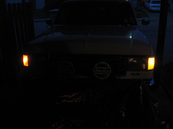

Front Hazards. Still incandescent on passenger, LED on driver. Notice how the LED turns on and off in a crisp and quick fashion, while the incandescent more or less ebbs on and off. That would get my attention more, I think.

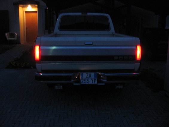

Rear hazards:

So to the review. Everything I received was packed well and in excellent condition. Instructions for all lights were included and very clear. With the rears you have to install a relay to cure some feedback problems inherent to Fords, and after spending the better part of an hour figure out what needed to go where(that was all me) it took about 10 minutes to solder the opposite side. Wire clip crimper things(pardon my super technical terminology) are included in the event that a soldering iron is not available or you don't know how you use one. Installing the rest of the lights is like changing a bulb. Take the old one out, put the new one in.
You might have noticed the LED in the above pictures looks pale and possibly less bright than the incandescent. I noticed this as well and part of it is the camera. This is not a fault of the LED, but more a design characteristic. They produce the same amount of light, but they are more directional, giving the impression they are not as bright. Also, given the housing were never designed for the bulbs would further explain this. There are many documented cases of the same phenomenon. The paleness is likely because of the housing and the bulb being a different shade.
