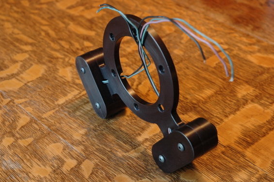

For a while now I've been wanting to use an aftermarket steering wheel to replace the thin stock steering wheel in my 84 Bronco. But, I didn't want to loose my cruise control (the switches on the steering wheel). I remembered that older Saleen Mustangs had the OE switches mounted behind the steering wheel with a special bracket. Of course finding someone that was willing to part with the original Saleen part would be near impossible. Amazingly enough, though, I found a machinist that has made new brackets that allow the use of stock Mustang switches just like the original Saleen brackets. The bracket is designed to be used with Momo/Sparco/any steering wheel with the 6-bolt pattern but I drilled 4 holes in it so I could put it all together with a borrowed cheapo Grant style steering wheel while I make sure it all works.
BTW: Most Ford cruise control switches are interchangeable (the resistance values) through 1996.
I figured I'm not the only one that has wanted to do this & thought I'd post the info. I'll post the guys email address later in case anyone is interested.
A new bracket:
My bracket after I drilled it for the 5-bolt flange:
Installed on my Bronco (excuse the ugly steering wheel, it's not staying):
A couple pics of the bracket installed on a Momo steering wheel:

Ditto for me... So do the switches stay stationary or do they turn with the wheel? If they turn, how do you keep the wires from wrapping?
Sign me up for that too!
The OE cruise control wiring is retained. It goes down the steering column just like the stock set-up. Yes, the switches rotate with the wheel.

I'm waiting for a response from the guy that made the bracket. I sent him and email asking if it was ok to post his contact info but haven't heard back. As soon as I do I'll let you guys know.
OK guys I got a response from Mark. He said he'd be happy to make more. I believe they are $85 and the come with the mounting screws for the switches. You will need to supply your own switches, but those should be relatively easy to come by at a wrecking yard. If anyone needs help with the wiring let me know.
You can email Mark directly for more information on purchasing the bracket.
