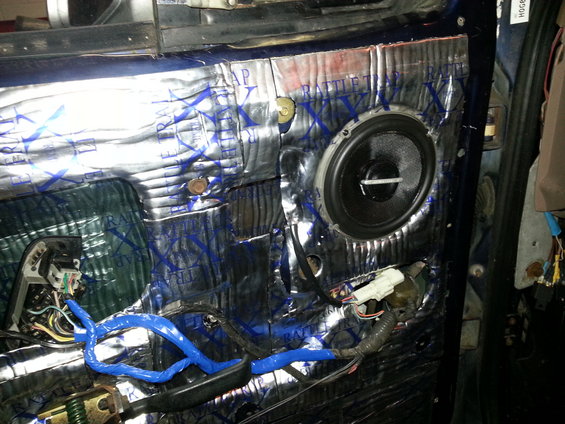

i used the JBL speakers for my bronco. awesome stuff. Door speakers fit perfect.

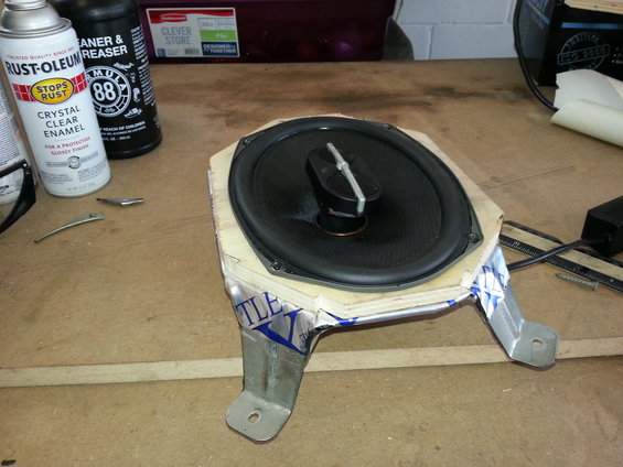

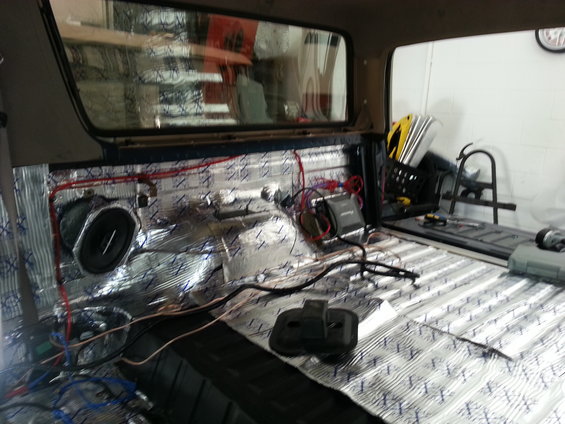

I did mod the rear baskets to accept 6x9's. it wasnt real easy but i did it.
First, i got some 1/4" plywood from lowes. traced out the outline of the basket on it. cut out the outside. then used the jbl speaker template to mark and cut out the inside. then i got my dremel tool and cut slices in the basket inner lip all the way around and bent them down out of the way.
Then mounted the plywood to the basket, then the speakers to the plywood. worked out perfect, no clearance issues at all. I did have to cut out the black plastic part of the side trim panels to fit the new spot for the speaker. I had to rotate it a bit to fit in place.
bad news was, after about 2 months of ear bleeding Rush and Iron Maiden, i blew the woofers in the 6x9. THey still sound great at low volume, but I am going to have to get some kind of sub to handle the lows and replace the rear 6x9's.
