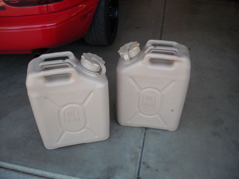

Stupid expensive, but they're what I wanted. I finally got some mad money that wasn't earmarked for other projects, so I said screw it and ordered them. Still need a water can, but those aren't as bad. I really should have spend the $$ on a new AC compressor, as it's getting hot, but what the hell... :toothless

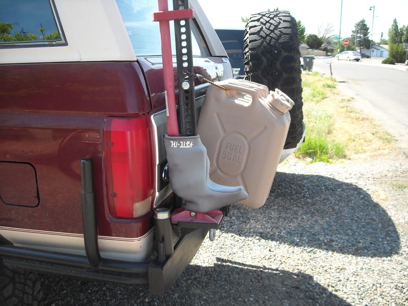

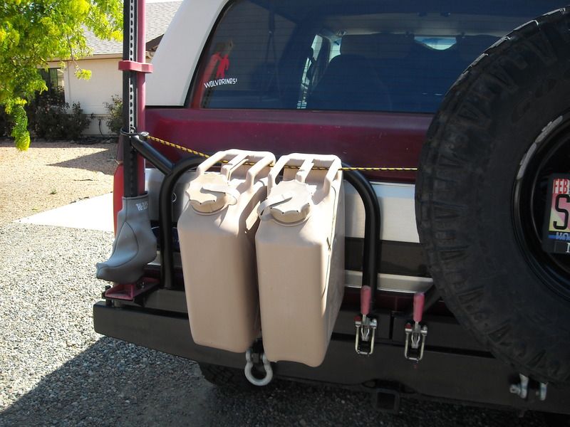

Basic idea of how they're going to sit on the driver's side swingout (plus the water can, there's room for all three). They'll be straight, not angled as they're just hanging on a bungee in the pic.
Now don't get all excited about progress, 'cause I'm full up on shit to do 'till August. And I still need to order some 1" dies for my tubing bender to get started on this...

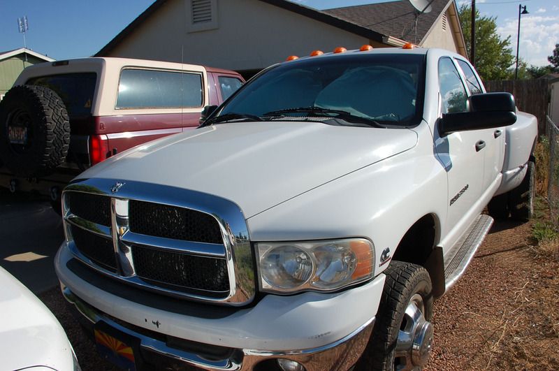

I've had two Powerstrokes, and loved them. But they're getting hard to find with a 7.3 in decent shape, so I opened the possibilities up for a Cummins. I also wanted a manual trans truck, which are rarer than chicken lips around here. This one popped up on my radar, and it was the first manual trans crew 4x4 drw I've seen at a price I could stomach. I was reluctant, as it has 200k miles, but it's the tightest, cleanest truck used truck I've ever driven. Not a squeak or rattle, steering tight as a drum. 2 owners, and 3 pages of service records on Carfax.

I know I'm crazy late to the party but I just stumbled across your build and love it man! Great ideas and "forward-leaning" to mitigate any future problems. I'm not sure if you've gotten around to fabricating the base for the cans since you got the 7.3 (sweet btw) but being in the Army, we have the exact same cans on the HMMWV's, Bradleys, MRAPs, etc. I'd be willing to bet that you could knock out a stable platform for your cans in a matter of a couple of hours. I think all you'd need is an old BBQ grill grate for the base and some 1-1 1/2" flat metal to make a border just to keep the cans in place. Just mount it directly to your swing arm, extended parallel, place two 45 degree pieces from the base to the vertical piece for extra support, and it probably wouldn't extend further than your spare. Then, we place a ratchet strap around them (cans) and they never move. I'm sure the bunji cord you had in the picture wasn't all it was cracked up to be. I see you have the bars on either sides of the cans, so those would make perfect mounting points for the straps. As far as limiting rattling, bumping, and irritation of the cans while driving, we would place a short, thick rubber bunji cord around the two inner-most sections of the handles. Never had a problem with how they were mounted and I can honestly say that they are able to withstand multiple IED's and other miscellaneous ordinance from any direction without fatigue.

Thanks for the ideas. The bungee in the pic was just to hold them for the pic, but I like the idea of using a rubber bungee as a damper. What I need to get them finished is a 1" die set for my tubing bender, as I plan to finish the structure in 1" tube. I also need that to get going on the roof rack.
