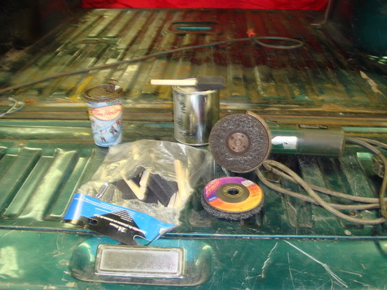

OK worked on the back of the bronco today, I just love this stuff!!
Ok you need your coffee, shit load of foam brushes, grinder and stripping discs, face mask and can of Rust Bullet. I spent no longer than 2 hours on this tonight.
This is what I began with.
Coffee break after 15mins and mask change, the spots is the result of dust in the air.
Time for a disc change on the grinder lasted 2/3s of the way.
Ok all cleaned up and wiped down with some sort of paint solvent that was in the shop.
Amazing!
Oh heck one more.
This shows you how much Rust Bullet I used to date and the amount of brushes I used in the back.
Stay tune as I continue onto the other panels.:drinkbud
